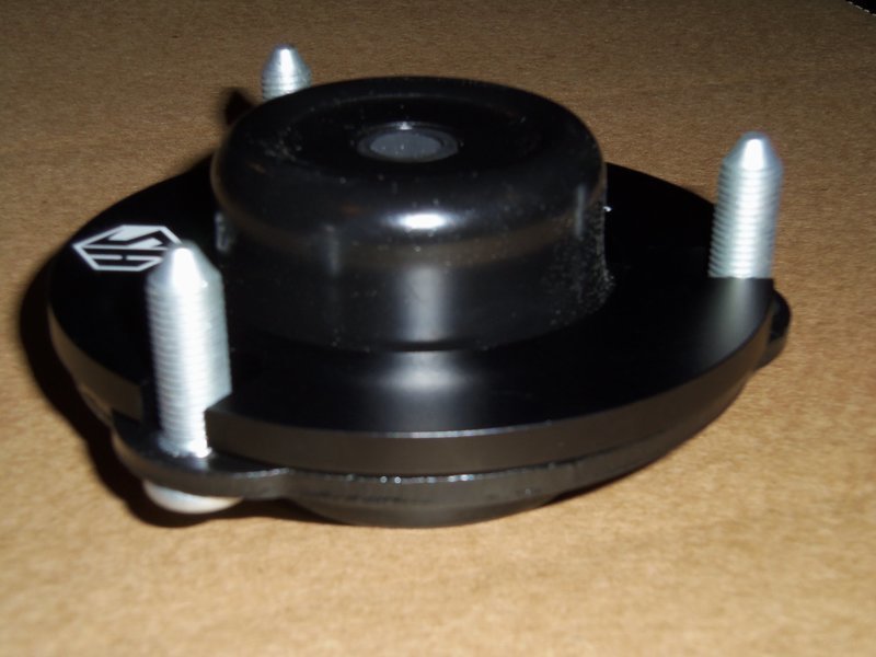

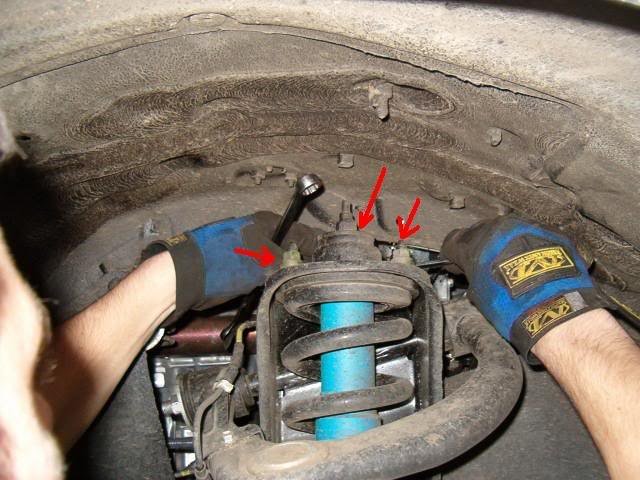

    Everything TW members recommend
    Any way to add a spacer to drivers side front without taking off the upper shock absorber top hat? I tried everything to try to remove the frozen nut and it absolutely will not budge. I already rounded out the nut. Used a bolt extractor, soaked in penetrant for several weeks. I could use some help from this wise group.
    See post #33 of this thread
  18. Mar 26, 2016 at 5:29 PM
    #4238
    Tacoma Mike
    Aug 6, 2011
    #61230
    31,216
    Southern Maine
    Take the strut down
    Spacer goes between the top of strut and the bottom of the strut mount as u reinstall.
    I have one. Just haven't put it in yet. Center nut does not need to come off on the one I have. You have a pic?

    I can't take the nut off the stud (see middle red arrow)
    I need to take all three nuts off to pull the top hat off, so I can insert the 1/4" spacer. In this pic, the spacer is installed on top of the top hat.

    Yes take the 3 nuts off. the lower shock mount bolt out. Drop the sway bar if you can. Pull the shock down pop in the spacer and reinstall. The big center one stays as is
