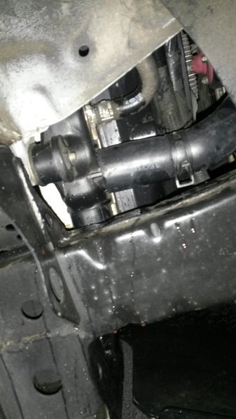

    Don't know if I forgot factory clamp back up to the radiator or it blew back. Idk but it was pushed back.i think the sound I heard was coolant hitting hot resonator.

    I pushed it back on before pick

    Had to stop again.
    Cooled down to 150. Stopped immediately at 220.
    Probably should change the oil after this.

  12. Mar 19, 2017 at 6:33 AM

  13. Mar 19, 2017 at 6:35 AM
    Tacoma Mike
    Aug 6, 2011
    #61230
    31,504
    Southern Maine
    You forgot to put the clamp on..
  14. Mar 19, 2017 at 6:52 AM
    Kolunatic
    Kolunatic Broke ass
    Apr 29, 2012
    #77862
    46,732
    Kevin
    Texas
    07 DC peerunner
    Kinda looks that way.

  17. Mar 19, 2017 at 6:53 AM
    Tacoma Mike
    Aug 6, 2011
    #61230
    31,504
    Southern Maine
    Don't add coolant right away.
    Let it cool. You don't want to cold shock aluminum motor.
    MQQSE, newb13 and Kolunatic[QUOTED] like this.

  19. Mar 19, 2017 at 6:55 AM

  20. Mar 19, 2017 at 6:55 AM
    Kolunatic
    Kolunatic Broke ass
    Apr 29, 2012
    #77862
    46,732
    Kevin
    Texas
    07 DC peerunner
    Thanks
    It's been cooling down fast with hood up. Looks like I'll be adding more supplies in my toolbox.
