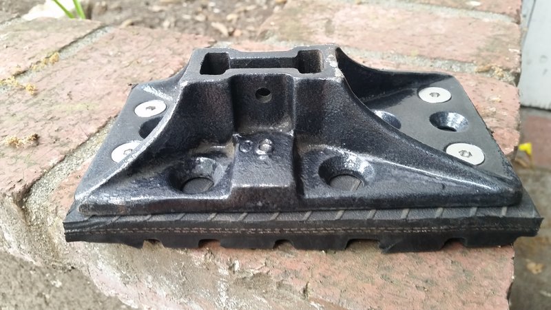

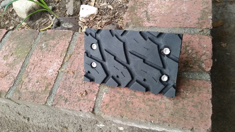

    Thanks to Sergio for the tire tread, drilled some holes and attached it to the base of the hi-lift. It gives it a much better grip.

    I like it.
    I have a relentless base but it doesn't fit mine good.

    I really like it. I have 2 hi-lifts at work and a couple old crappy tires. I'll have to see which one is going to sacrifice itself.

    Probably doesn't matter, but I put my bolts facing the other way. I figured the head of the bolt would be less interference than the nuts plus whatever exposed threads. The way you have it, I'd be concerned that the mounting bolts would act like spikes in golf shoes and not allow the rubber to make full contact with the ground. Just my observation.

    For the dirt, I'm actually hoping the bolts will actually sink in and act like spikes to give it a little extra grab. I was thinking about cutting some 1" plywood I have to make "street pads" for when I have to use the jacks when I'm not in the dirt...drilling some holes for the bolts to sit in so the rubber makes full contact on the wood, possibly adding another tire tread to the bottom of the plywood pad.

    I countersunk the bolts so they won't touch the dirt, should be good
