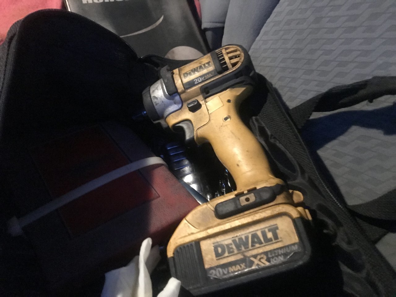

    I’d like to see what ya used to get brake lines off

    Yea but what adapters? Crow feet?

    Crows feet do work and I do use them however two were so seized I felt it starting to round off the nut head.
    So the lines were trashed anyway so I cut the line off and used a socket to grab all 6 sides.
    I used my mini torch for 30 seconds just to get The molecules moving and not damage the unit.
    It’s either go or blow in situations like this. I lucked out..
