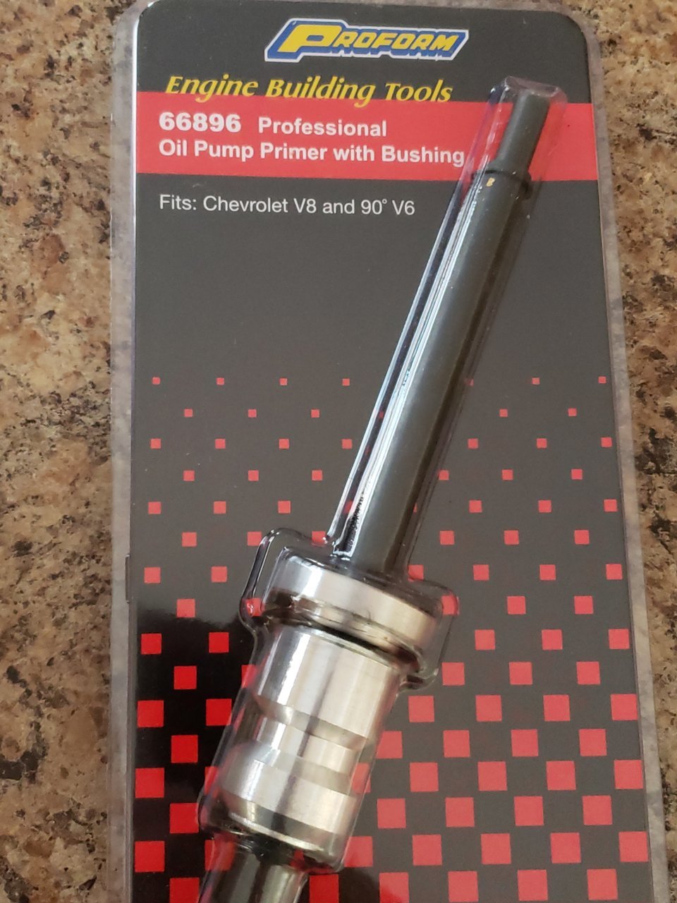

    Just for new motor first start or oil system mods
  4. Jan 29, 2020 at 5:29 PM
    Kolunatic
    Kolunatic Broke ass
    Apr 29, 2012
    #77862
    46,732
    Kevin
    Texas
    07 DC peerunner
    Yep
    An old distributor an a drill
    Duh

    We used to make them out of a trashed distributor and just spin the pump with a drill till oil was coming out of the push rods . Same as your setup @Tacoma Mike ?? I might one day build an engine again so ..;)

    @Tacoma Mike do they pre oil new engines they send to you guys or if you know those crate motors people order ? I have never seen one in person only in jegs or summit etc so no idea .

    You always want to pre oil any assembled motor just before first start.
    Even if you had a dyno sheet with the motor I’d still want to pre oil the first time.
    But to be honest they are not pre oiled per say.
    Ours are not complete engines anyway and they are not dripping oil in the transport bag.
    Kolunatic and Cypherian[QUOTED] like this.
