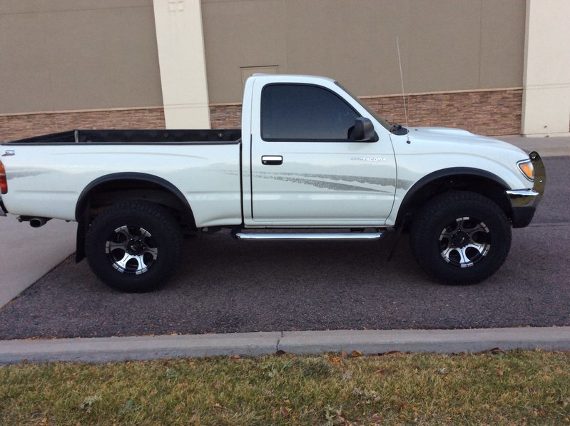

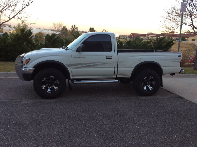

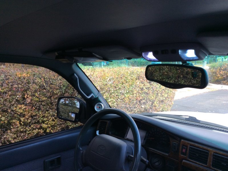

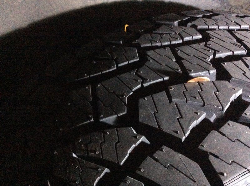

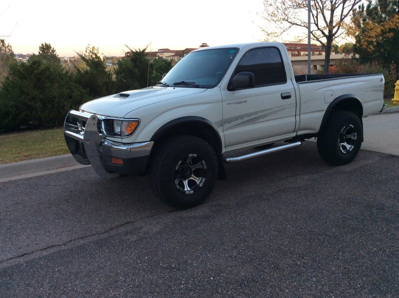

    Added a few upgrades this last month,

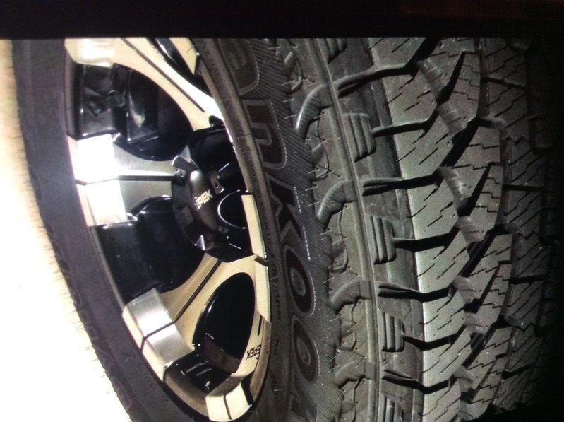

    A functional hood scoop, some new Dynapro ATM, A penny in the tread almost disappeared,

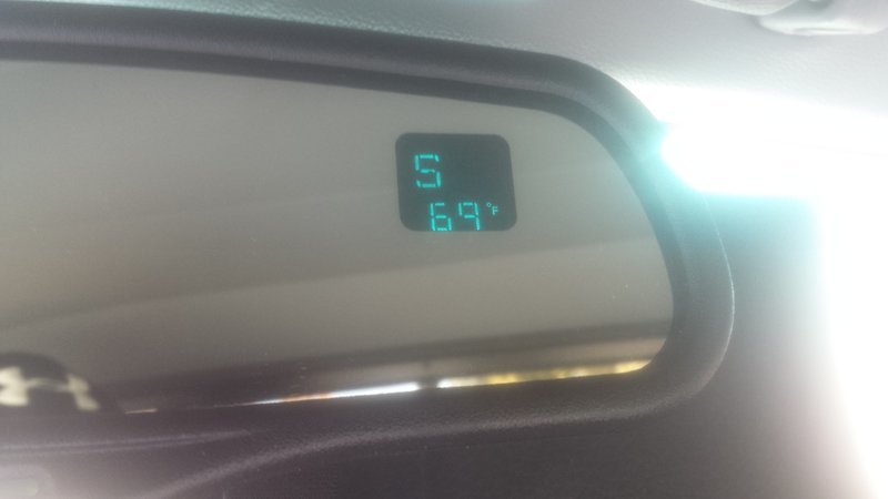

    A Gentex 453 Auto dim + Compass + Temp mirror,

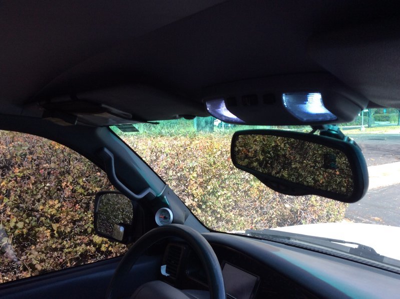

    A 4Runner dual map light with LED bulbs ceiling light

    Auto dim mirror? Any pics or a write-up? What car did you get it from? Sweet truck, man!

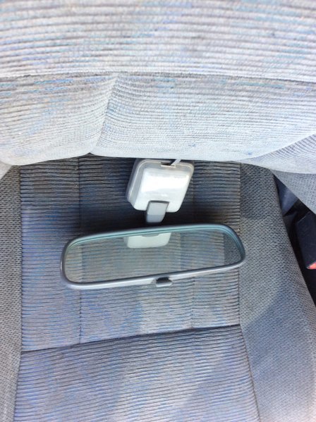

    Thannnnk you,
    The mirror is modle Gentex 177, it's a GM mirror, so at any junk yard are plenty,
    You need the temp sensor also, or you can buy these off eBay with the wires and complete setup
    for 75.00, got mine off eBay and had all the parts I needed for 75.00,
    It's pretty easy to do just takes some time and patience, 2 hours, had to run WIRE through head linier, so HAVE to fish it though to the side post cover and run wires to power under dash and the other 2 wires to
    the head light area for the temp sensor. It's great to have a mirror that dims automatically now and

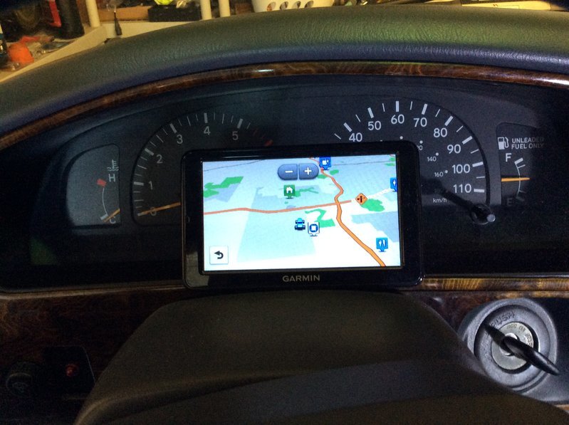

    have the temp and compass there all the time. Also a photo of my GPS mounted on steering column out of the way.
    Is a nice clean setup and replaced the single map light with a dual lamp.
    Also 2004 door mirrors are a great upgrade as you see here

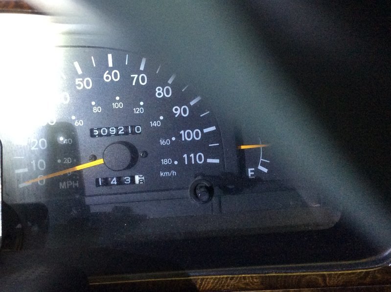

    A little more now 509,000

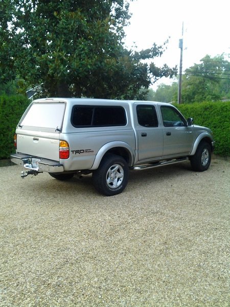

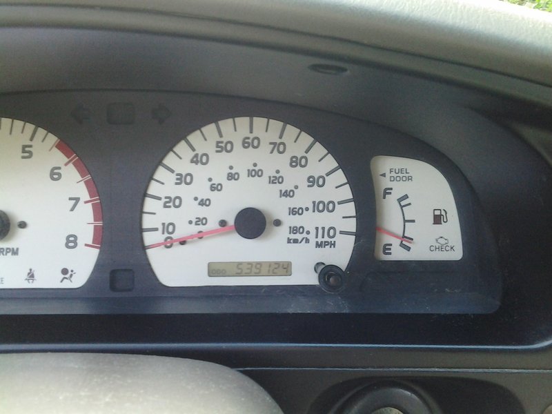

    I check this forum once or twice a year. I posted my Taco last year when she made the 500k turn.
    540k original miles today and still tickin'.

    same engine?

    Original miles--original engine, original tranny. Doesn't burn oil, still shifts fine. Unreal.
