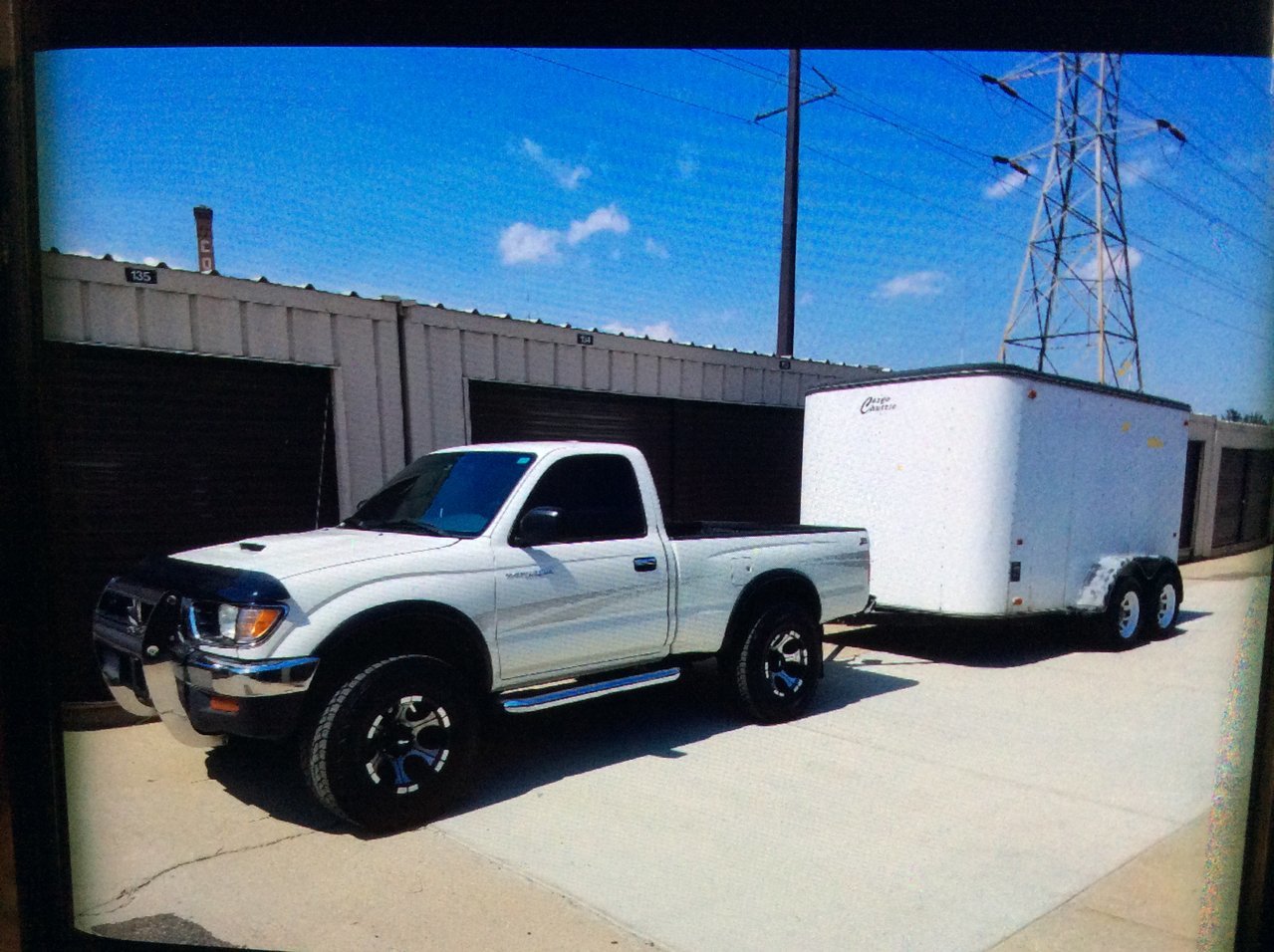

    97 reg cab, v6 5sp 300hp supercharged, Methonal Injection, 750,001 plus miles, Original Owner
    V6 5sp,RegCab,TRD Supercharger, 1.9” pulley, methanol injected Haltech ECU, AC TRD supercharger,(MUST DO) TRD supercharger ported, every 125,000- 150,000 needs rebuild Projector headlights HID 5 speed manual Amsoil for all drive train Smaller 2” pulley, (MUST DO) 2004 DESNO fuel injectors, zero ping ping, 2004 side door mirrors Dick Cepek Rims, Michelin tires LTX, ( that last 100,000 miles) Now running Dynopro ATM mud and snow tires KN cold air intake Cat back exhaust with ss exhaust tip, Raised exhaust tail pipe to 2" below body line Optima*dry cell battery,red top Alpine sirius radio, 200 watt amp, focal is165 split door pod speakers Focal door speakers Subwoffer behind seat Viper alarm, Electric Locks Dark tinted windows, bucket seats corbeau lg1 Tacoma Rubber floor mats TRD fender extenders, Bilstien shocks, King shocks nerf bars, add a leaf for rear springs trailer iv hitch, electric brake control, Drilled slotted brakes, High carbon steel (MUST DO) EBS green stuff 7000 series pads(MUST DO) TRD engine oil cap TRD stick shift, Marlin crawl shift kit. Rear sliding window 2002 4Runner functional hood scoop cut into Tacoma hood, 4Runner dual overhead map light Gentex Auto dim + Compass + Temp, garage,rearview mirror Snow Methonal kit stage 2 Custom 3 core aluminum radiator Linex bed liner Haltech stand alone ECU, Intake supercharger gauge. Stainless steel brake lines, Custom leather wrapped steering wheel,
    Thanks!!
    The nerf bars and push bar I bought in 1997, I don't think they are around anymore,
    Headlights I replaced with HELLA H4 E-Code lens( not sealed) and then added HID bulbs to the Hella lens,

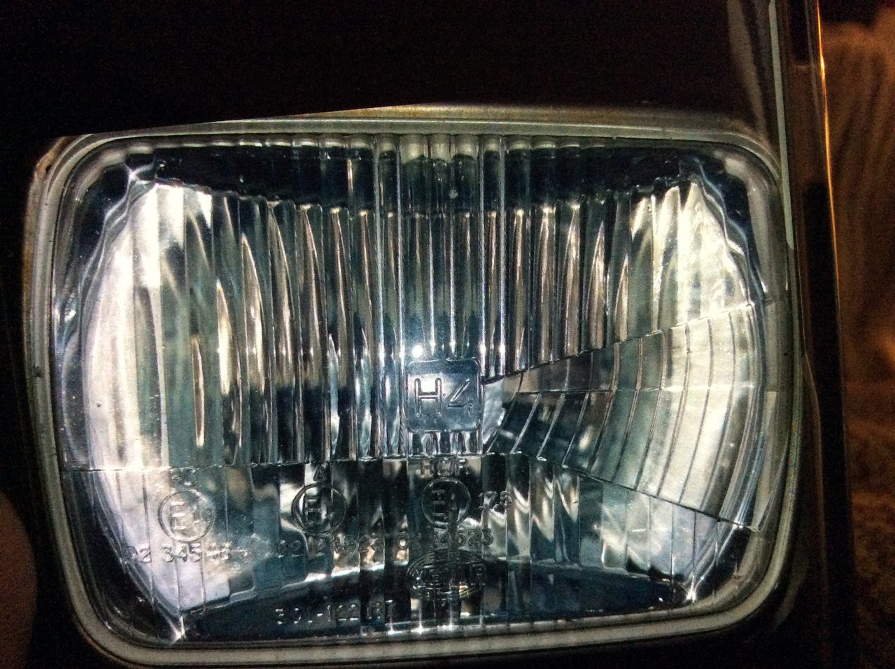

    How does it cut off? I have Hela too and with quality H4 bulb they are superb.

    I have the E-code Hella H4 glass lens, nice cutoff lines if you have the rectangular lens like mine, I have the Hella European version so there is a little light desperation.
    Hella E-Code Conversion Headlights
    Before the modern aerodynamic lamps that today's cars come with vehicles had either round or rectangular headlights. Two large round 7" headlamps such as the original Mustang, Camaro, Alfa Romeo, Miata, Porsche, Mercedes Benz and most motorcycles and trucks or four smaller 5 3/4" headlamps such as Cutlass, Chevelle, Daytona, Corvette C2, C3 or two large rectangular 200mm headlamps as the C4 Corvette, Jeeps, or four smaller rectangular 4"x 6" lamps on some vehicles like Volvo and Chevrolet. These original sealed beams are not much when it comes to driving safety and are easily over driven at 50mph. Even the halogen sealed beams are only a small improvement as their lens flutations and glass reflector are very poorly engineered and quality of production is typically very poor.
    In Europe with the unlimited speeds of the Autobahn and the over all higher road speeds allowed in most countries, driving safely at night was part of the normal engineering concept and long range lighting was expected as standard equipment. These European Hella H4 e code replacement headlamps have a precise low beam cutoff which gives a nice blanket of light on low beam instead of the two dots on the road, which most sealed beams provide. Also the Hella H4 low beams are more effective in fog and snow than most OEM fog lamps and give less glare to other drivers than sealed beam lamps.
    High beam gives a long range driving beam that illuminates road signs and animals eyes for quite a long distance.
    These lamps are not DOT approved and are intended for performance off road or show usage.
    They totally light up the road for me and because of the sharp cutoff they do not blind the oncoming driver. A world of difference between the standard lens and bulb

    I ditched OEM SAE approved sealed lamps long time ago. I got E-coded H4 Autopal, and they are very decent and legal in Poland :thumbsup:. However it is important what H4 bulb is inside. The crappy "noname" cheapo that came with lenses were really crappy comparing to OSRAM bulbs I bought few days later. So my question is how HID H4 bulbs are doing in your housing.

    I'm happy with them, some people say it's the wrong combo, maybe so maybe not, but I'm very very happy, night and day difference for me

    I bet, but really what I'm looking at is does Hella keeps stable cut-off (flat with raised on the right site) with HID bulb or the HID bulb creates some ghosts or so.

    Mine look completely straight, I will get a photo when I get a chance
