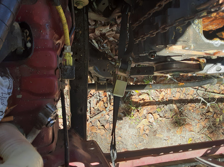

    Update- Okay... This is so frustrating that I'm just laughing about it. The pictures are of the setup that me and my cousin devised in order to TRY and pull the motor. Nothing. Tried the clutch trick, but nothing. So right now at wit's end, angry and just laughing about it. Any tips that don't involve yanking the transmission would be greatly appreciated.
    I'm not selling it. This is going to be a legacy vehicle that my children will learn to drive in. Hence why I'm prepared to dump money into it. If it was the Maxima or Impala I owned, it'd have been sold. But it's not. It's something I've been searching for for years.

    Are you referring to hard it is to break the grip of the dowel pins between the block and trans.?
    Yes, seen it that bad. Used wedges. Start small and use penetrant at the dowels. They have a serious galvanic bond going on.

    Yes. I am referring to the dowels. We managed to get a flathead screwdriver tip in but nothing came of it.
    And it seems the displacement number is cursed. Seriously.

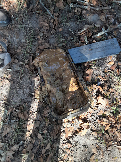

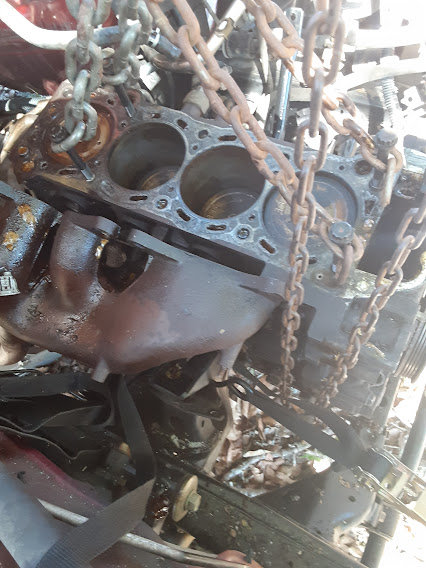

    Been a bit but figured I'd keep ya'll in the loop. Update- Well... After grunting, shaking and pulling, and prying the motor finally came out. The pictures are self-explanatory... Also, we found rust on the crankshaft and the rods. Not sure what to do from here. My options are limited to my budget of x amount of dollars. I've been stuck in a slump due to the discovery of rust. Machine shops near me won't rebuild the bottom end. To top it off finding a replacement motor has proven to be difficult, if not annoying... Going to make a decision over the weekend and let ya'll know.

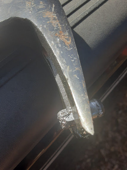

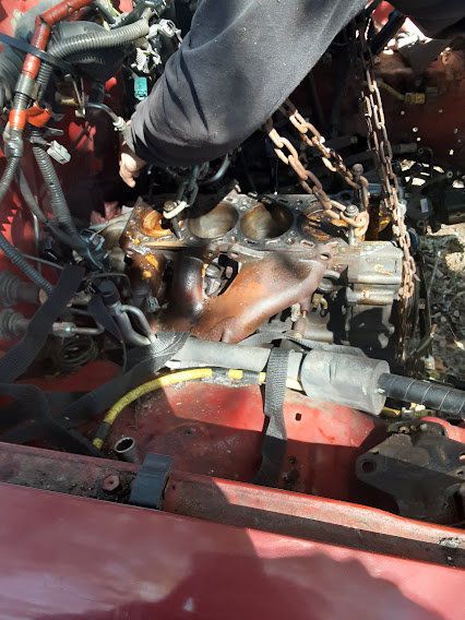

    Update- Oooo boy... SO close but so far away. Snagged up a $700 motor. For about 2 weeks it hung over the engine bay. Why? Because a guide pin was in the same place on the transmission and the motor. A friend of mine chose violence to remove it. After removing the pin from the engine, it was slapped in. Now I have a couple issues.... One wire seems to go to nowhere. Some of the various parts I have to put back on have been sitting for a while.

    This is/was the guide pin that was in the way. As I said in my update, my friend chose violence. Kinda wish that I thought of it BEFORE spending 100 on a dang impact and drill bits... No matter.

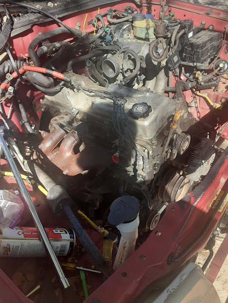

    And this... This glorious picture of the motor is one of the latest victories. The 700-dollar junkyard engine sitting in its rightful place, inside a 500-dollar junker truck. Shout out to Hunt's Used Parts in Asheboro, NC. They were a bit surprised when I showed up to buy this thing but they were very professional, gave me a 90-day warranty, and told me all they could about the motor before I bought it.
