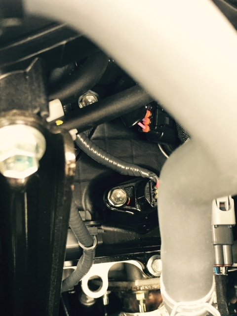

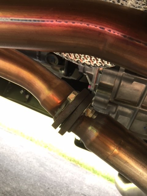

    This sounds like almost the exact same issue I had with my first 3rd gen Taco. Bought a 2016 SR5 back in July 2016 and at 1,600 miles it developed an oil leak at the exhaust cam shaft position sensor on the drivers side; oil would pool up in a spot on the head (see image) and then run down hitting the exhaust manifold. The local Toyota dealer replaced the sensor thinking the sensor itself was the issue. After replacement the leak continued, so I called the dealer I purchased it from and they came and picked up it.
    Master Tech at that dealer stated the cam shaft journal bearing cap that the sensor bolted into seemed to have some level of porosity, and oil was being pushed through the bearing cap and into the bolt hole for the sensor. The oil would then run up the threads of the bolt and out onto the valve cover. They stated they would have to pull the timing cover, cam, and replace all journal bearings on that cam. According to the service department Toyota did not have the parts necessary in their main warehouse at the time. I opened a case with Toyota when the leak first happened and the representative I spoke with stated I should pursue requesting a different truck from the dealer. Luckily the dealer offered to replace the truck before I even asked and offered to bump me up to a TRD Sport for my troubles. On another note, the TRD Sport they gave me had an exhaust leak off the lot, so Toyota gave me an extended warranty on that truck due having two trucks with factory defects in ~2 months.
    I would at least pursue a platinum level warranty with your case manager from Toyota; that is what they offered me.
