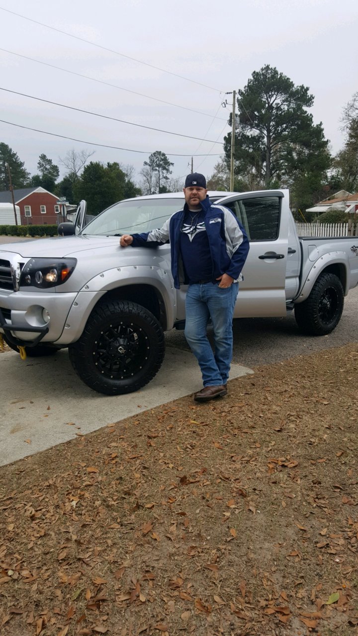

    9531.jpg I have a 2005 TRD, it's got 415,561 miles on it. That's right, 415,561 miles on it. Every 7000 miles OEM Toyota filter and royal purple full synthetic.

    Wow! What (if any) major issues have you run into in that time? I just hit 100k and i'd love to get another 10 years out of it!
