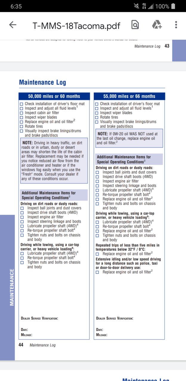

    Yes they do, and I hear they are better than the Automatics. :rofl::rofl::rofl::rofl:
    But yes, I think its easier for people to ask online than it is to go out and look through the book. I have the manual on a PDF so I can pull it up on my phone anytime.

    What TW recommends and what the engineers who designed the truck recommend will vary. I would just go with what the manual says. Cost will also vary, but I can get an oil change and tire rotation from my local Toyota dealership for around 70 bucks.
