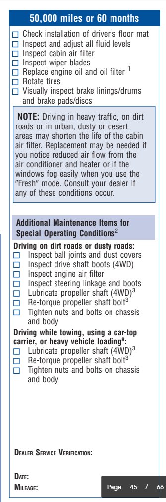

    so before you flame me for not searching first, i did. however nothing came up as far what the 3rd gen 50k mile service includes. according to the minimal research ive done its a basic oil change and tire rotation. now if this is in fact the case i prefer to do the work myself and save a couple dollars while gain a slight sense of accomplishment and manliness. Ive heard you should grease the drive shafts every 30k as well. does anyone know if theres zerk fittings or how one greases the shaft (hahaha) with out a zerk fitting. thanks, cheers.

    That is mostly because services tend to repeat. The 50k is similar to the 10k. From the Warranty and Maintenance Guide:

    if you dont have zerks there is nothing to grease. My 2016 has drive shaft zerks, my 2017 doesn't.
    Oil changes every 10k is the extent of it. I'm at 83,xxx and all I've done is oil changes, new tires, and differential and transmission fluid.

    theres nothing reguarding the 50k mile service just general pm work. i checked there first
