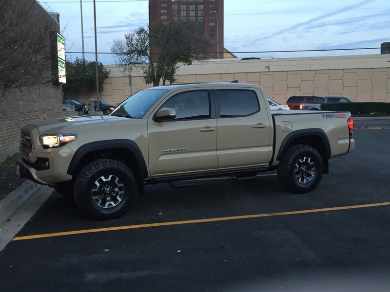

    5100's @.85 w/ 1/2" shims in back 265/75/16 tires
    Not much different, just a little less bouncy and a little bit firmer, I prefer the ride over stock. Tires are p rated so would probably ride rougher with LTs.

    Do u feel u got 1" lift up front with the billy's set at .85. If so, I'll look into a 1" block in back. I think with a canopy I'll still have some rake, but not too much.
  4. Apr 10, 2016 at 1:08 PM
    #24
    jerseymike
    jerseymike [OP] Well-Known Member
    Sep 17, 2015
    #164477
    130
    Allentown, NJ
    2016 Tacoma TRD OR DCSB MT 4x4
    You know what, I wish that I measured bUT eyeballing it I think it was about an inch.

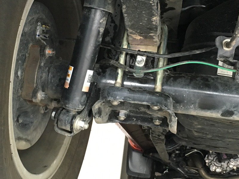

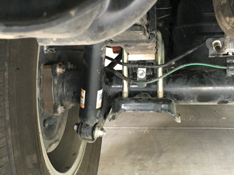

    No special tools and it is not too difficult but was a bit time consuming.
    steps are the following:
    1. jack up rear of the truck with a floor jack on the rear differential high enough to place large jackstands under the frame rails.
    2. remove rear wheels
    3. unbolt rear shocks
    4. unbolt the small bolt holding the rear brake lines to the leaf springs
    5. unbolt the rear u bolts completely
    6. remove the bumpstop
    7. unbolt the center bolt holding the leaf pack in alignment
    8. slowly lower the jack until the axle is separate from the leaf pack enough to insert the shims with the new leaf pack alignment bolt
    9. reverse of the above steps
    a couple tips:
    the new bolt that goes in the center of the leafpack needs to be hacksawed around 1" off
    the new 5100 shocks are a little hard to push into the bottom mount due to the rubber bushing being new....I used a rubber mallet and then my hand to wiggle it in.
