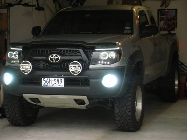

    Well, The wheels/tires that came on the truck were 31.5x11.5x18 and they rubbed the frame so 5100s set on 2.5 got me off that and allowed me to go with 32x11x18s without any rubbing anywhere. Didn't feel the need to buy new rims to go back to 17s so yes, in my case, more than looks and yes, the UCAs allowed caster to be correct and it rides/drives like a truck should (for me)...even with E load tires and progressive TRD springs on them. It'll get a bit harsh on crazy offroad stuff but I don't do any of that since it's prerunner.
    Went from this.........
    to this..............
