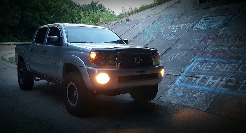

    18T4RORP 17GT350

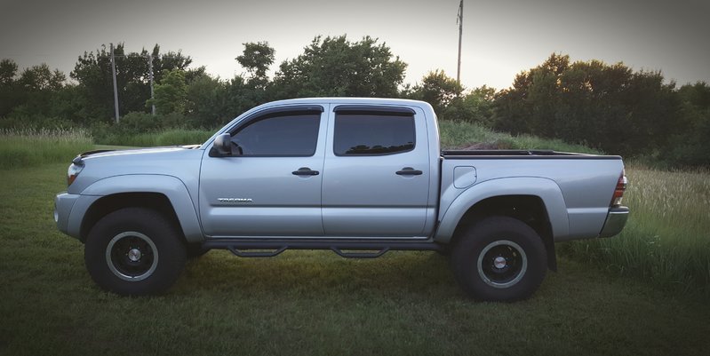

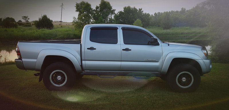

    Anyone seen my wallet?
    Up to 80mph on a toll road, no complaints. I put on big ol heavy tires which changed how it handles and drives more than lifting on stock UCAs. I havent driven one with aftermarket UCA's so i dont have anything to compare to however.

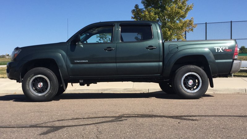

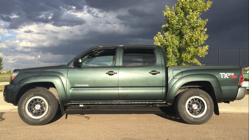

    Got some things sorted out this weekend and am able to post before and after pics.
    Stock 2011 TX Pro, 107K miles on stock suspension w/ 265/70-R16 Michelin LTX M/S2's:
    Installed lift 8/14/16.
    Rear:
    Replaced stock springs with a set of used 3-leaf springs from a stock 2014 TRD from @Coop68 (Thanks Coop!).
    Deaver AAL from @HeadStrong Off-Road
    U-bolt flip kit also from HeadStrong
    Rear shocks are Bilstein 5100 series #33-230337 from @Downsouth Motorsports.
    Front:
    OME 885X coil springs used from @trint99 (Thanks Trint!).
    Bilstein 5100's #24-239370
    Had some vibrations all around but was able to sort out the rear. I had -3.6* down on the jack shaft and -1.2* down on the differential. I had picked up some 2.5* shims on a guess from HeadStrong so I guessed right! Rather be lucky than good any day! :thumbsup: :bananadance:
    Still have some issues up front though. Need to replace my wheel bearings and I have a frozen alignment cam sleeve on the driver's side front. Oh well, my tires need replacing before winter anyway so alignment can wait until I get the other stuff done.
    As it sits today:
    Before and after center of hub to fender measurements:
    Wheel Before After
    LF 20-1/4" 22-1/2"
    RF 20-1/4" 22-5/8"
    LR 21-5/8" 24-3/8"
    RR 21-5/8" 24-3/8"
    So this has given me 2-1/4"ish lift up front and 2-3/4" lift in the rear with an 1-3/4" difference front to back. The 885X's have 20K miles on them so I am not expecting them to settle much. The rear leaf's had 40K on them but the AAL is new so I'm thinking I'll get a little settlement out of those. I carry 200 lbs in the winter so a little higher in back is perfect for me. All-in-all I love the stance of the truck and the ride. Still got some work to do to get it all final adjusted and then new tires! :yes:

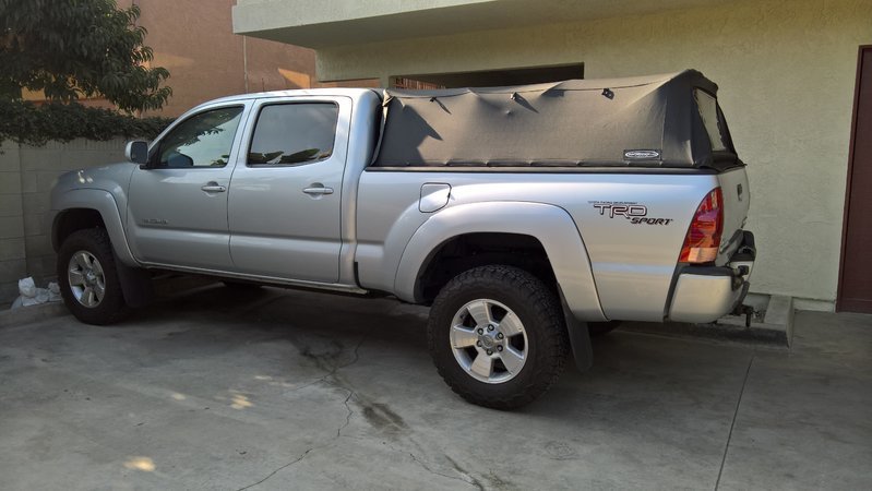

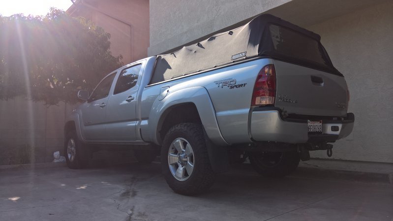

    finally installed! Got just over 2.5" and it's a perfect height. Install was mostly easy since I had a few friends who have done it before helping and plenty of tools. Hardest part was lining up the add a leaf. Oh and somehow stripped a lug or the stud on my rear driver wheel. What the hell that's never happened to me before. Haven't driven it more than a few miles and gonna wait til UCAs arrive to do alignent next week. This looks great with my 265/70/17 k02s. Room for bigger next time!
