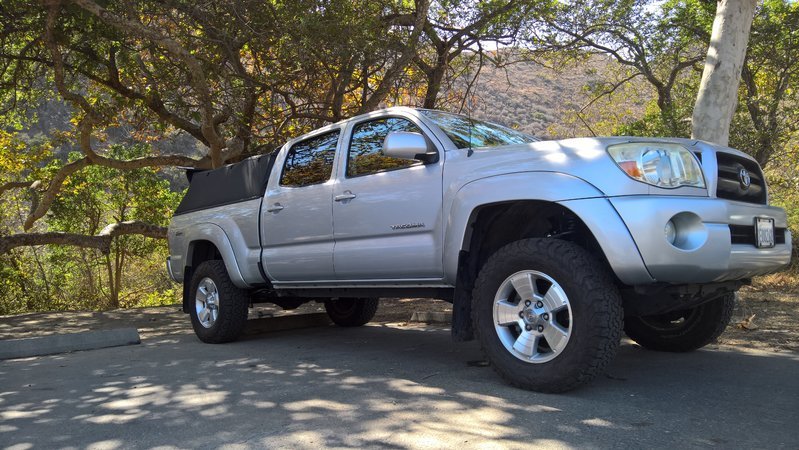

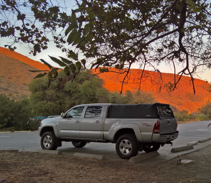

    first drive with my lift and ucas decided to go on a trip up PCH to Point Mugu. Drives great!!!

    Damn! Looks great! Is it everything you imagined and more? haha

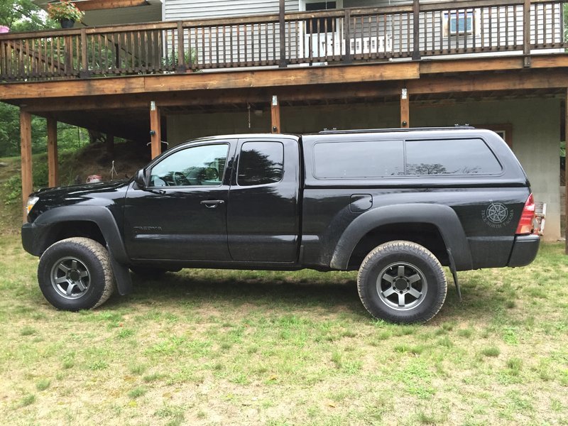

    Truck looks great man! Leo Carillo!!

    thanks! A few miles further north... Sycamore Canyon Campground at Point Mugu. Very similar. Campground is less of a walk to the beach, although this one has no general store. Both are great places
