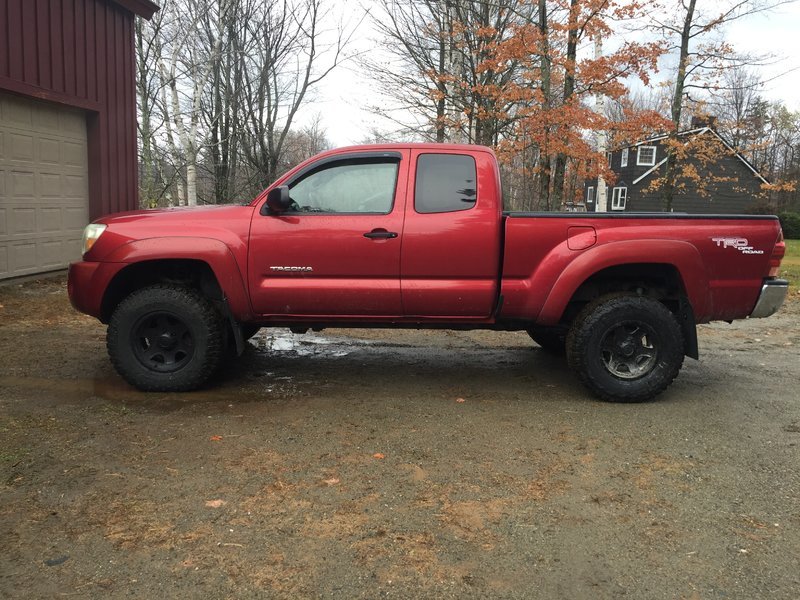

    As promised. 885's/5100 + 2" wheelers AAL in the back. Immediately after install I got 2.5" out of the AAL. Cap will go on this week helping it settle.

    mike
    2011 dcsb trd white
    none
