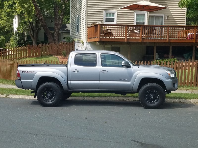

    I know this is from September, however this is what I have been contemplating to do with mine, 884's instead of the 885's. Do yo have before and after measurements of height and what did you do for the rear with the extra weight of the cap? How do you like the set up after a few months of having it? Does it still ride smooth? Thanks in advance.

    I got a little over 2" in the front,after settling.I have the 2.7,5spd.In the back I have the three leaf aal,it sits dead level.In hindsight I would have gone with a whole new leaf pack in the rear.I would talk to Marie @HeadStrong Off-Road for advice,hope this helps.

    which 2" aal did you go with? My 1.5" deaver is already sagging with under 100lbs of constant weight.

    I went with the wheelers 2" pack talked with Yota Dan

    I love that this thread is staying alive with people who are happy with this setup and getting the answers they need about it! There's some awesome looking tacomas posted here. My setup is almost a year old now and I still love the way it drives, wouldn't change anything about it. Looks amazing and feels even better. We're supposed to get almost a foot of snow here tomorrow and I have to go into work at the hospital in the middle of it. No 4wd but hoping for the best haha.

    I have the same lift 885s, 5100s, icon 3 leaf aal and jba uca's on my 2014 trd sport love the ride

    How are you liking the JBA's i plan on getting them if i go higher in the front currently at approx 2.5 thinking of going with 887
