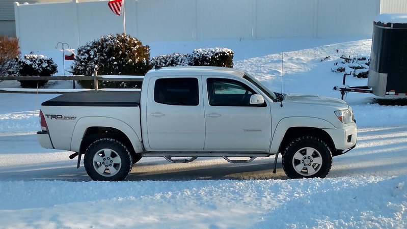

    They look good, and you won't have to trim like 285's. Any wider than 265 and you may rub your uca's unless you add wheel spacers.
    Here's a pic with 885's and a 1.5" AAL.
