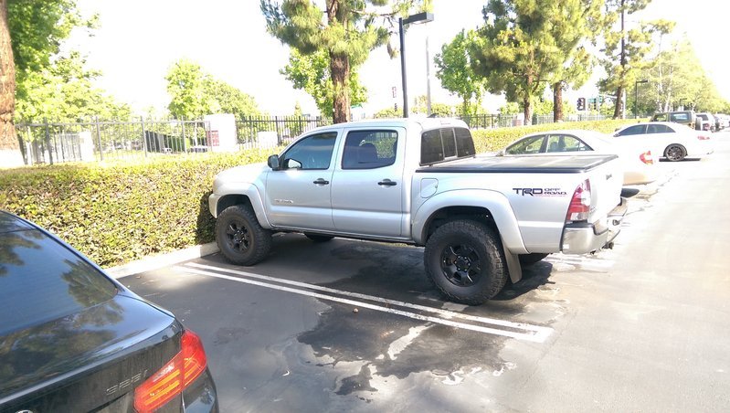

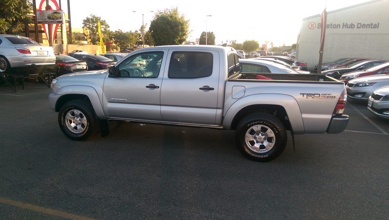

    Actually, I lucked out. I just had to remove the mud flaps on the front wheels and i get no rub with regular street / Highway driving. Not sure how it will sit after the suspension settles. I'm sure i will get some rub when i go off roading, but for now she is one sweet parking lot princess. haha

    Looks great OP. appreciate the full parts list and so many pics. It definitely helps me make my choice.

    Damn she looks good! Loving the silver and black, silver wasn't my first choice when I got my truck but now it's turning into one of my favorite color schemes.
    No problem buddy! Glad you found it helpful! Like I said, I did months of research going through endless threads. It's threads like this that made it easier for me.

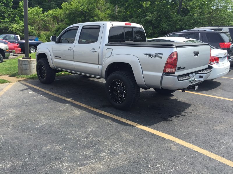

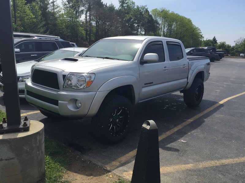

    Had the lift on for a couple weeks now. Finally got the wheels and tires mounted. Still Fighting a bad vibration though.. CB drop did nothing. Thinking 3 degree axle shims next? Or maybe Diff drop? Not really sure.image2.jpg image1.jpg

    Looks awesome man! What size tires? A lot of good looking silver and black tacomas here. About the vibration, did you say if you tried the driveshaft spacer yet? Only like $12 bucks at wheelers. It fixed my friends vibe that he had so I just installed it at the same time as my lift.

    I replaced the carrier bearing first. It was shot, But that didn't fix the vibration. I've tried Dropping the carrier bearing. That did nothing. I have a set of 3 degree rear axle shims I'm going to try next. If that doesnt work.. I'll order a front diff drop I guess.

    I'm not sure buddy, I got lucky with no post-lift issues. Drives smooth as hell. Tires look good What size tires did you put on?

    Thanks! Went with 275/65/18

    Good Looking truck. Sucks about the vibes. I dig the plasti-dipped emblems. I can't decide if i want to do mine, or remove them. Now at least i know what they will look like.

    I actually bought black ones. I work at a GM dealer so we do a lot of business with the local Toyo guys. Got them all for a good price.
