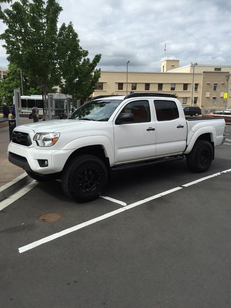

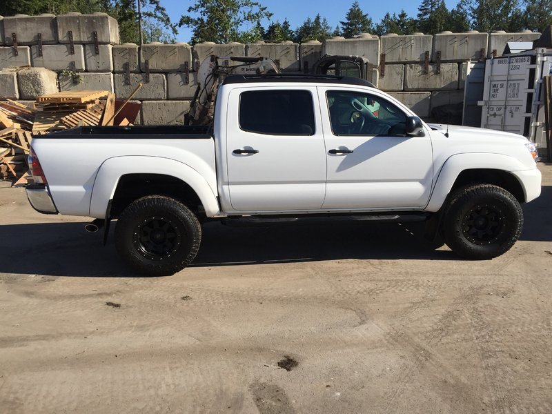

    Here is 265/75/16 (32") with 885 coils and 5100 on the front. The rear has a .5" AAL with 5100. 5100 are set at 0 - no preload. Truck sits level with this setup.

    Do you mean 1.5"?

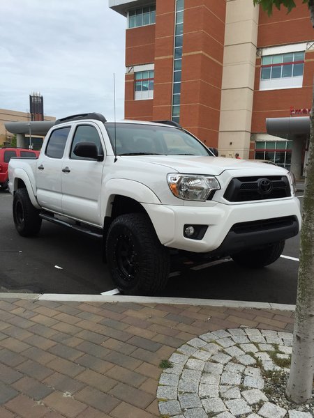

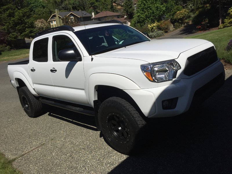

    ...for comparison here it is with the same setup in the front but with the Dakar leaf pack in the rear. image.jpg
    I personally like the look of the truck better when it was level but I tow a tent trailer so when it's hooked up, the truck sits perfectly level which is what I was after. I hate when the ass end of a truck sags when loaded.

    No, I meant .5". The truck had the 4 leaf pack from the factory. When I lifted it with the custom AAL the shop told me it only required .5".

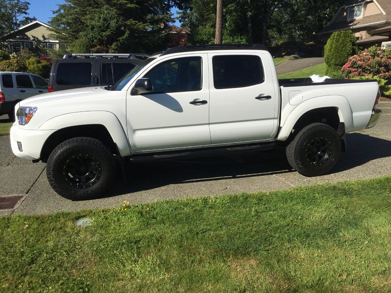

    ...and that's why I went with the Dakars. I tow out tent trailer and yard stuff. The front just looks a little too low for me now.
    Hauling:
    Dakars with close to 750lbs of top soil in the bed. Nice and level. No headlights in the trees or oncoming traffic.

    Looking at your truck, you have more rake then I did with the .5" AAL.
    Truck looks good brother. I had a deposit on a 6MT MGM TRD Sport but decided to go with the white SR5. Other then the seats in the sport, there wasn't much on that package that I could justify the extra 3K for. Although the paint matched everything on the MGM looks sharp, I didn't like the look of white mirrors, door handles and rear bumper on the SW. Thought it looked better with the black accents. If I had to do it again though, I would go with the MGM Sport. Black wheels look sick on that color.
