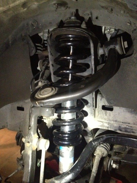

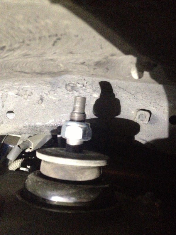

    I installed my 5100 and OME 885x coils today and ran into a couple problems. First off I forgot the washer that goes on the top of the shock underneath the top plate (my bad) so after taking it all back out and installing that washer and putting it all back on, the top nut on each shock can't go any tighter and I have about a 1/8-1/4in gap between my bushing/washer and the nuts. So there is like no pressure on the washer and bushing. Do I need new bushings? Not sure what the problem is.
    I used the method on here following the video.
    The second issue I have is that I'm way to dreaming high in the front!!! I'm gained like 4in from top of tire to wheel well!! What the hell!? An one ever seen that much?
    Any insight would help. Thanks!
    here are some pics.
    this is before i added the washer i forgot but its still doing this even after iput it in. just not as much. like 1/8-1/4"

    The shock rod bushing and washer pattern should be like this:
    Nut
    Washer arching down
    Bushing
    Top plate
    Bushing
    Washer arching up
    Shock plastic dust cover with metal insert
    As for the ride height, double check the bottom coil spring perch is not upside down and the coil spring it's self is not upside down. And for the 0 setting the c-clip should be at the lowest setting.
    Post some pictures...

    Uuh. Those look like the 5100s for 1st gen tacomas. The lower spring perch looks like black steel. Not the unpainted aluminum on the 2nd gen.
    Plus you are missing the dust boot...

    Yes it does matter. The plastic boot has a metal spacer inside it that will cause the shock shaft to stick up past the top plate if not used. You can take the metal spacer out of the plastic boot if you want but it needs to be on the shock under the bottom washer.
    Not sure if they changed to black steel coil seats for the 2nd gens. If so that's news to me. If they did not change to black steel spring seats then maybe they put the wrong spring seats in your boxes...

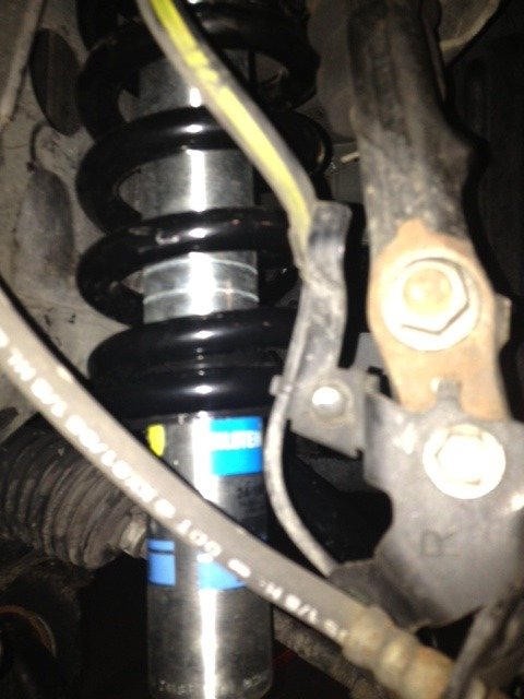

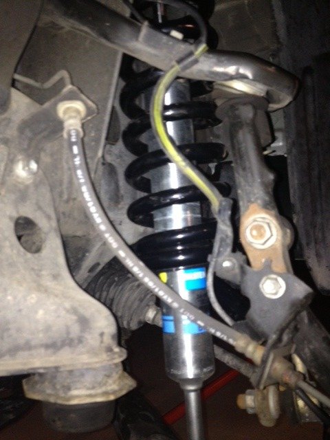

    ok guys, the spring pirch is not upside down, the coil is not upside down, and it is set on the lowest setting. to me it almost seems like the shocks are too long or soemthing.

    I can tell from the pic they are set up correctly as far as the spring cup, you are just missing the dust boot.
    You may just need to drive it a bit and see if the springs settle. Have you driven it at all?

    Not enough.
    In your fourth picture they do look awkwardly long. I used to have them and remember them being shorter.
    You should measure them off of the shock and call up some places to compare numbers.

    Well I looked and the new shocks are almost exactly the same size as my old ones. The 885s must be giving me too much lift...
