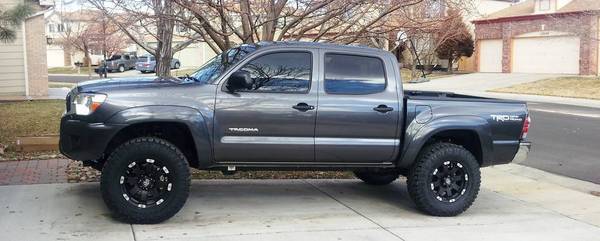

    Just got mine done last Friday. 5100's all around, 2.5" in the front with 2" AAL. Rides great.

    Dude these last two photos look good.
