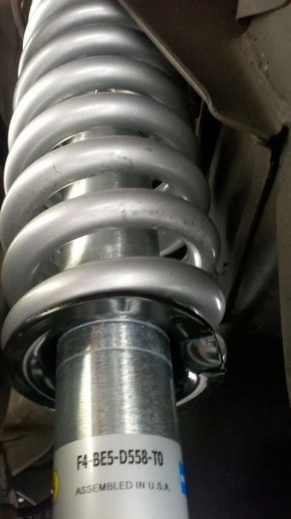

    No, don't do that... Over 3" of lift without lift spindles or a diff drop isn't a good idea. Once the 885's settle or for people with plate bumpers and winches, they have set them to .85 to maintain their lift but I wouldn't go over 3". For 4wd Tacomas, you can wear out your CV's very quickly.

    Alright thanks, I didn't think you could but reading that made it sound like it was possible.

    FWIW: Just talked to ToyTec, they said they sell the preassembled Eibach/5100 coilovers at 0" and don't reccomend anything above .85"

    UPDATE: Had the 3/4" spacer installed and the billies dropped to .85"
    Huge difference in the ride.
    Thanks for the help guys.
