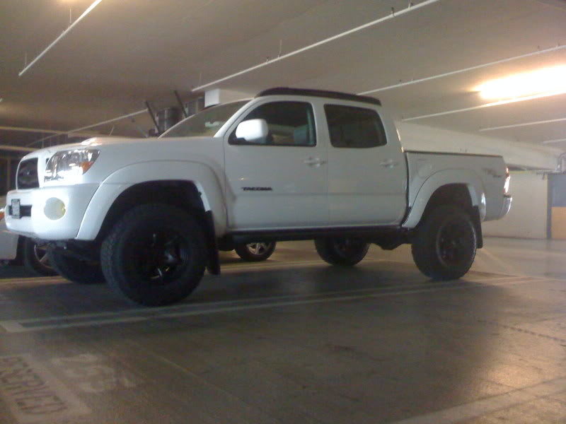

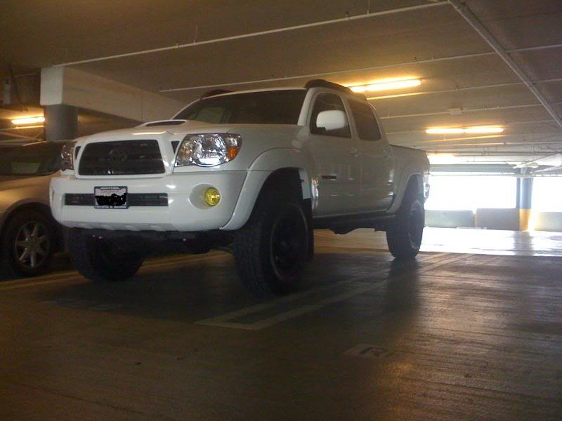

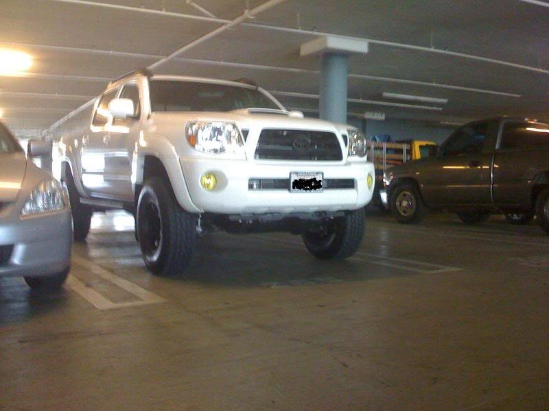

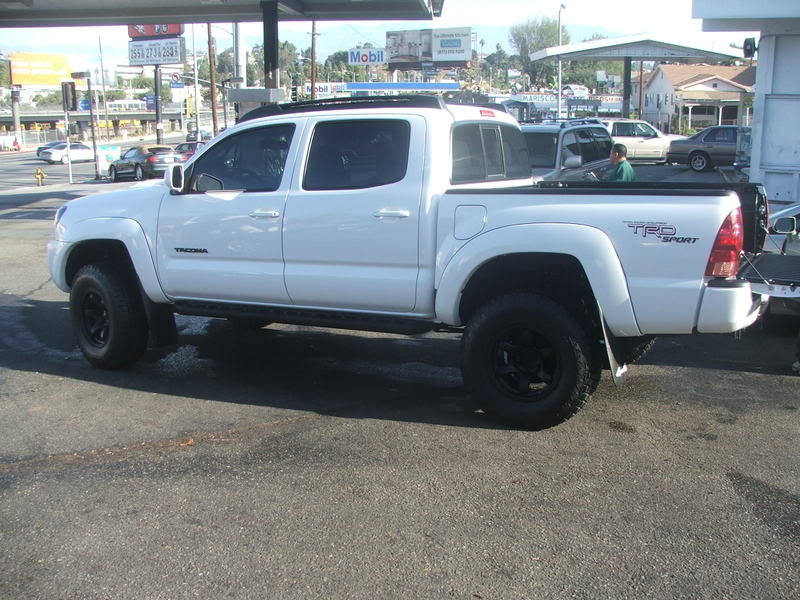

    The rear will sit a little higher. This is my truck setup at 2.5" up front with 2" AALs in the rear.

    looks like the perfect lift.... I have the TSB done in the rear how do you think that compares to your AAL???

    Damn I'm jealous, that is exactly the look I'm going for... thinking about toyo m/t 265/70/17's

    I actually just removed the AALs and got the TSB done today. I think it sits perfectly leveled, but the springs still need to break in.
    The truck drives 10000x better now with the TSB as oppose the AALs.
