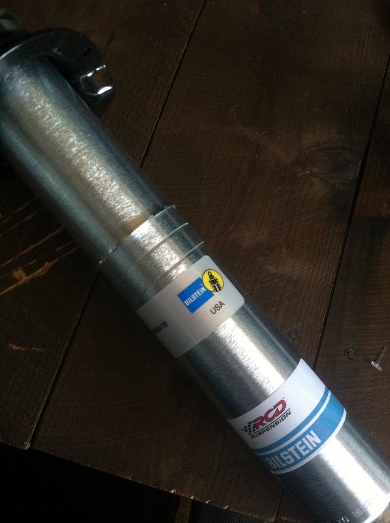

    I got my 5100's in the mail and upon inspection, the c-clip appears to be sitting in the uppermost groove. Am I correct in assuming this is the groove for the most lift? I want them set at 0 because I will be running the Eibach coilovers from Toytec. What is the best method for repositioning the c-clips, or are they already in the correct groove for 0" lift?

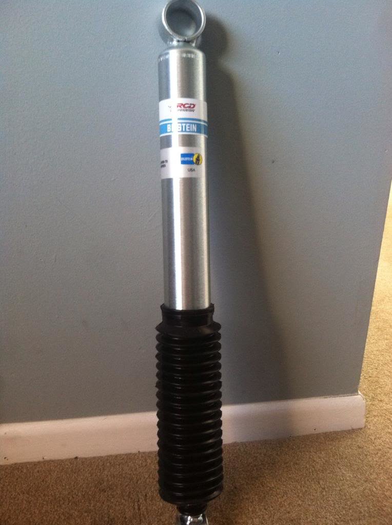

    Probably not last and definitely not least...I've seen plenty of opinions regarding the dust boots facing up or down. Any solid information as to which way is best? I'm leaning toward installing them boots-down as that is how the labels are oriented, and it seems the boots would do a better job of protecting the shock from rocks...

    Yes the c-clip is in the 'most lift' position. They are easily moved by prying out of one groove with a small screwdriver and sliding down the barrel to the next.
    I left the rear shock boot on the bottom.

    X2 the clips can be moved with a flat head screwdriver or something similar and yes you are at the 2.5" setting as it sits so move it all the way down.
    Now for the boots what do you mean up or down?...just leave them the way they came.

    Boots down according to the paperwork that came with mine from Wheeler's.

    X2 the clip needs to be at the bottom grove. I was like you. I didn't want my truck down too long so I ordered my 5100s and OME springs preassembled from wheelers ready to install. they did an awesome job on preassembling them. They went rite in and had the alignment done and off I went.

    Boots down water and mud will sit on the shocks if the other way around and could eventually cause premature failure.

    As for the front shocks you need to move the c-clip down. As stated above.
