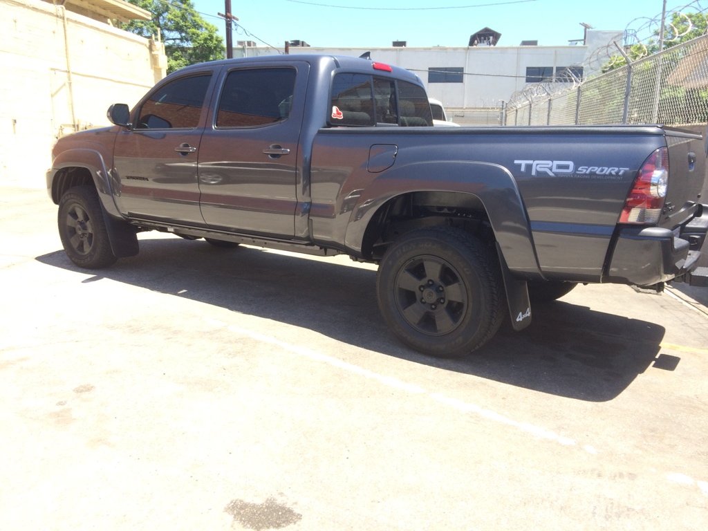

    Added my AAL, this is the method I used: lift vehicle and place of stands high enough to take all play out of the suspension, c-clamp leaf pack, lift diff up to hold it up while you loosen bottom strut and remove bolt, loosen u-bolts and remove the nuts, take off bump stop and remove nut that holds leaf pack together. Once that is completed you can lower the rear diff, this gives you access to the leaf pack bolt, remove and replace with longer bolt insert AAL between overload leaf and leaf pack. Make sure all lines up and the bolts goes thru each leaf, after doing so put the nut back on and screw in all the way down. If you do not have enough room to place the new bolt in(such in my case) I used a tie down to bring the leaf pack up like this:
    After doing so raise diff up to bring pack all together and release the tie down and remove it before you completely tighten the pack together or else it'll be stuck in between leaves. Replace bump stop and u-bolts(be sure to center the u-bolt plate name tighten evenly. Remove c-clamps and replace rear strut and bolt. Tighten to spec. I am not a professional mechanic, only a guy doing this myself so I don't give the dealership $1000 just to install my 5100s, Eibachs and AALs. I am not liable for your mistakes, this is just my adventure and way I achieved my install and lift.

    sweet man looks good cant wait to get mine in what size aal did you put in and what did you set your 5100s at

    I put a 1.5 inch AAL, that's what head strong had suggested without getting a longer strut and minimizing the chance for vibrations. So far so good.

    .85 up front with Eibach coils.

    any pics
