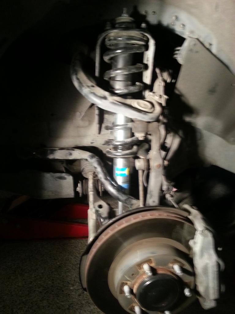

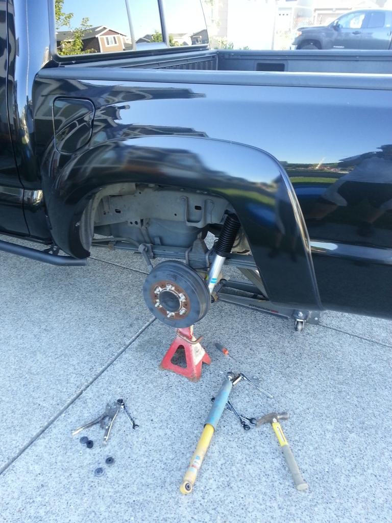

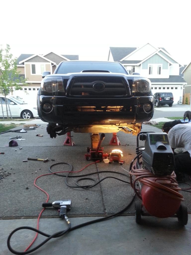

    MrSmith253
    MrSmith253 Well-Known Member
    Oct 15, 2013
    #114516
    206
    Cameron
    Fife, WA
    2010 supercharged 4x4 trd sport
    Got them installed Yesterday front set at 1.75 and 1.5in Toytec AAl rides amazing little bit stiffer on bumpy side roads but highway and city streets much better then stock
