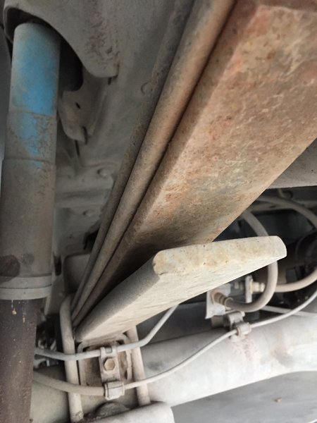

    You're right, I should have said ride heigh "accommodating" for the rears. But I will try 1.75 for the front and see how she looks. Do you happen to know what stock ride height of the rear is off the top of your head for and 05 4WD TRD? I can't tell if the previous owner put an AAL back there or not.

    No. But you can take a picture of the rear leafs and post it. We can tell you.

    Looks stock to me.
