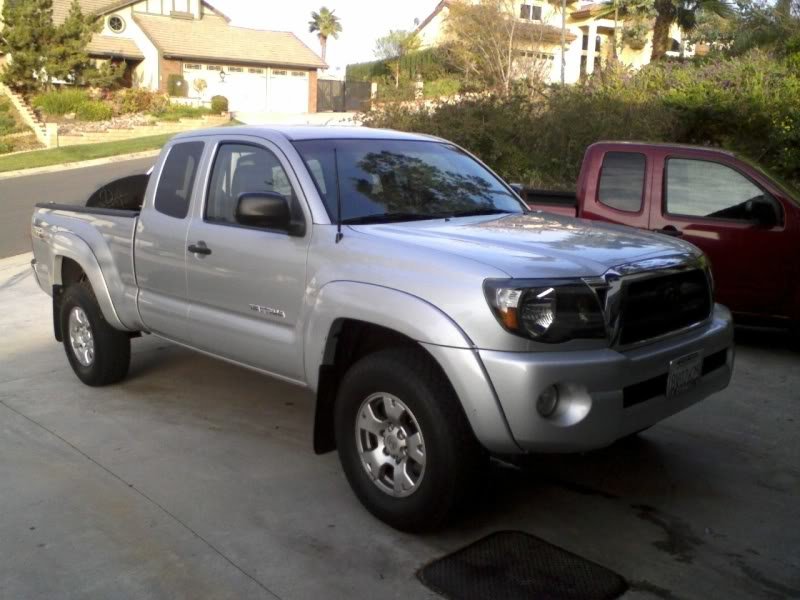

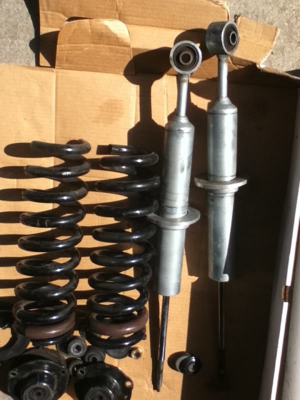

    Hey guys. I have a stock tacoma that I plan on lifting. I am going to have to end up ditching my plans for ICONS since money is a little tight. Anyways, Im going to buy some bilstein 5100s off my friend for 100 bucks and I was wondering if you guys had any input on how front billies set at 2.5 would look? I dont have a rear TSB or any other mods to the rear suspension. Heres a pic of the billies..
    and heres a pic of my truck so far. Im kinda done with the "looks" mods and Im wanting to do something with my truck that would make it look more agressive and perform better offroad with a budget in mind.

    for the OP: You will have a pretty decent bro lean. If thats the look you are after then you are set. If you want to be more level then lower them to the 0.85" setting.

    The settings on the billies are designed for stock coils. if you upgraded coils you would have to set it lower to compensate for taller/stiffer springs.

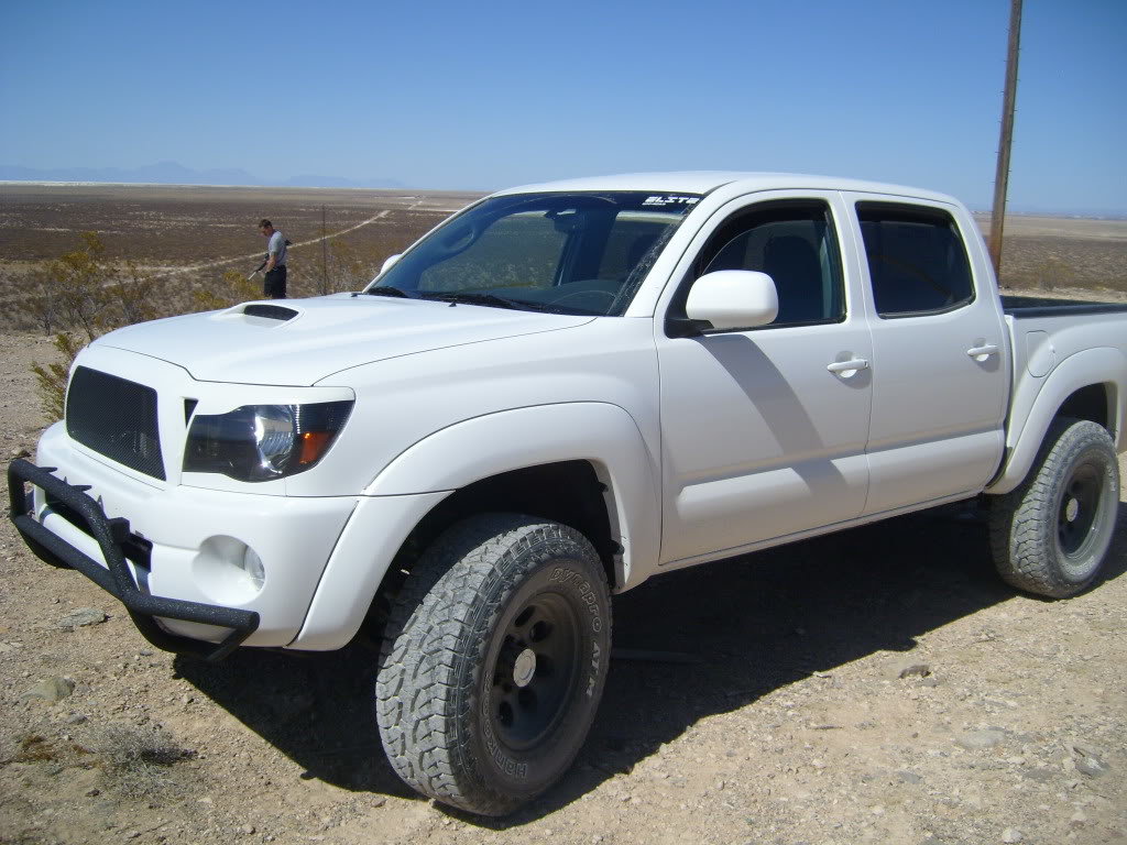

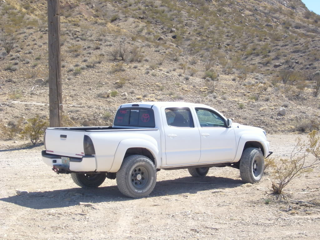

    mine @ 2.5 with rear TSB

    What kind of rims are those? May I ask how much they set you back?
  19. Apr 8, 2011 at 1:31 PM
    #19
    Detective_Dan
    Detective_Dan "Place original and witty user title here"
    Dec 8, 2009
    #27235
    4,528
    Jason
    Colorado Springs
    2014 DCSB Beast / 2016 Yamaha FZ-07
    Pelfreybilt Front Plate Bumper, Brute Force Fab High Clearance Rear Bumper, Pelfreybilt Sliders, OME 886/Dakars, SCS F5's, 33" Ko2's, Cobra 75WXST/3' Firestik, oil catch can, aero turbine 2525, rear differential breather extension, bedmat, weathertech digital fit front/rear, BHLM, custom shiftknob (made by me),
    pro comp 8069's
    they will not fit without caliper modification. if you are interested in them, click the link in my signature that says "Wheels Dont Fit?"
    they were about $500 brand new for all 4 wheels

    What size tires you running?
