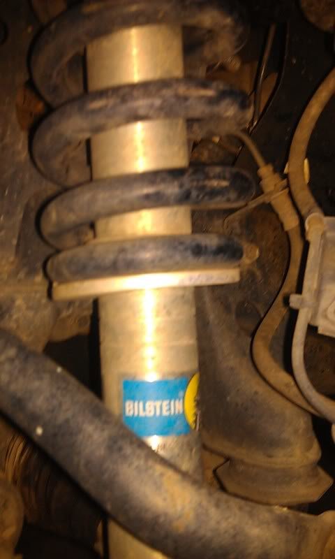

    While stopped it sits right next to it. Bump hitting any bump hits it up against the coil hold on Ill get a picture

    Can we get a pic of the shock seat please

    Tell me exactly what you mean by that so I can get the right picture

    Yeah, i was thinking he might have installed it upside down.

    And make the picture bigger this time please :D

    [​IMG] Best I can get

    definitely upside down

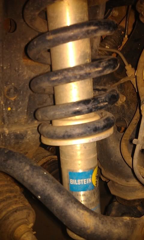

    YEP. Your installer installed the "pirch" upside down. That's why it looks so high lol. Heres a pic of what it's supposed to look like.

    DO NOT drive it like that. There is nothing holding the c-clip in place and it could snap and shoot the spring off.

    So your saying my truck wont sit as high as it is? :(. And is that why my UCA is hitting the coil?

    Yes. You have about 3.5" or more of lift right now with the pirch upside down. Your UCA's are stretched over the max.

    You guys are positive on this? Because the pirch (how it sits now) has a groove where it looks like the end of the coil is supposed to rest on

    Just take it back apart and flip the pirch. Lol. You can't ride around like that.

    Positive. When installed correctly, the spring perch envelopes the c-clip, holding it in place.
