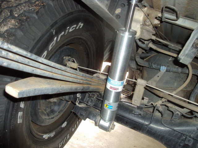

    I just installed 5100's (F4-BE5-D560-TO) on the rear about a week ago & I swear about 75% of my axle wrap has gone away or is very slight, has anyone else experienced this ? On a recent trip to the desert they performed flawlessly....
    These are the Bilstein's built to RCD specs.

    Looks like it is mounted upside down.

    I just mounted them the same way the old yellow ones were .....

    I've heard that same old debate on mounting them shock tube up & down, personally don't think it makes a difference ...

    i dont think it matters much, shit just tends to get on the piston. Did they come with boots?

    x2, but I don't think it will matter much without boots to catch stuff against the shaft though.

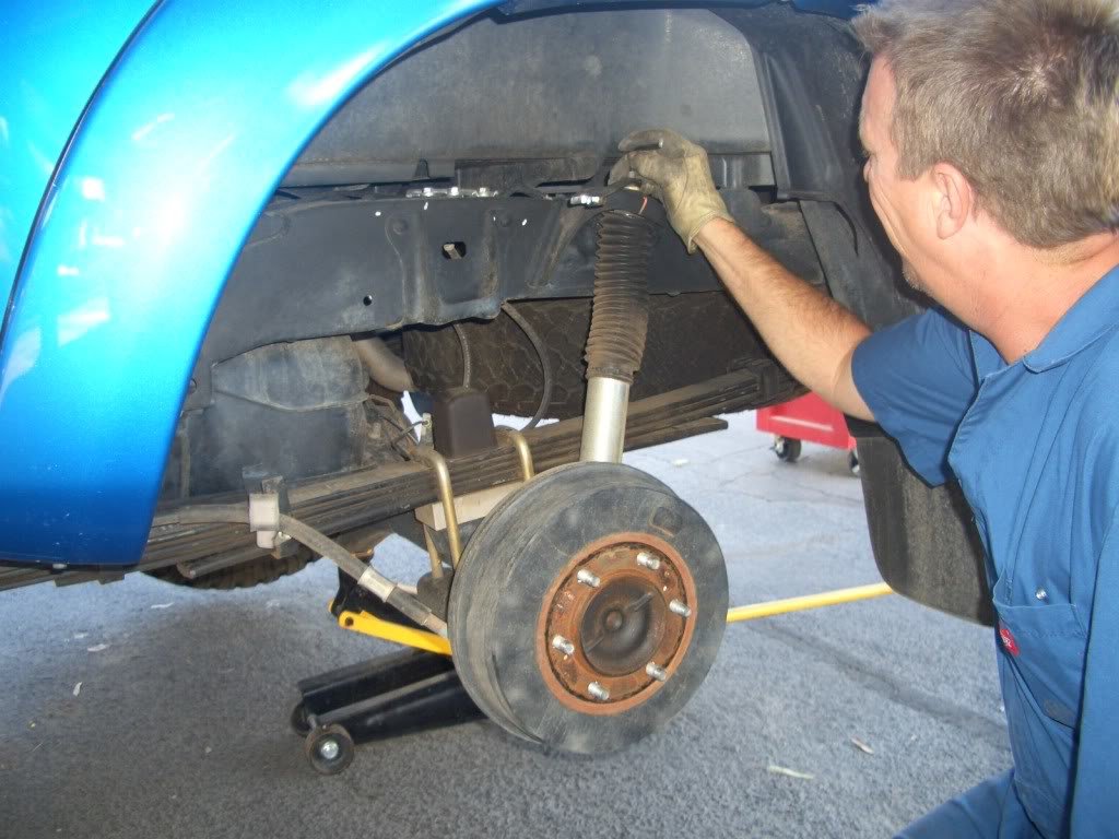

    Most of the rear end pictures on this site have the boots on the top. That's how i have mine. Just like the OP said, that's the way the stock ones were.
    here is a pic of the master Chris4x4 doing his thing.

    I looked forever to find some Bilstein documentation that would tell me the right way, because I didn't want a bunch of asswipes being dickheads about it. (Oh, and I also like to do thingsthe right way, duh.)
    I did find some Bilstein doc that said they were designed boot down, but they won't work any differently upside down. Further, without boots, the shafts are better protected the way you mounted them.

    Some shocks it doesn't matter. Some shocks it does. Some shocks have a little bit different valving for compression vs. rebound.
