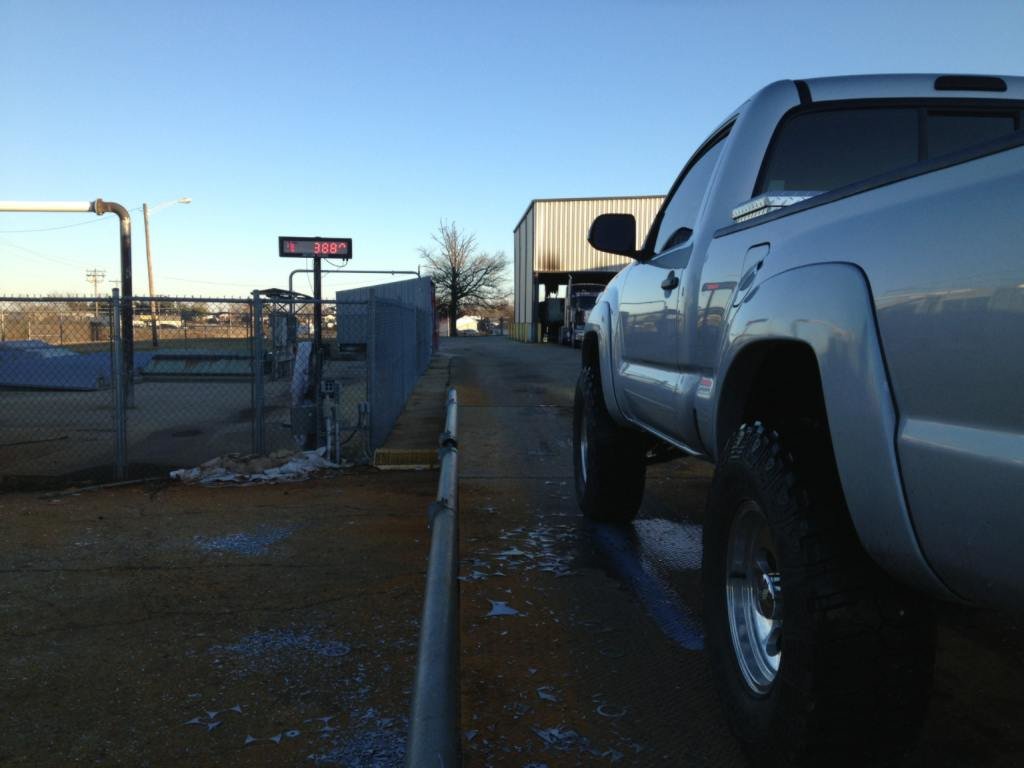

    I'm not over 5k lol haven't weighted it yet..we need to go to the BS thread..haha

    Mine is 3800lbs
