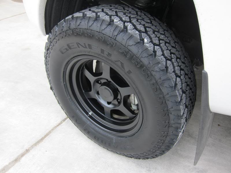

    just got the General AT2's in 265/70/17 with 4.1" backspace and only had to remove the front mudflaps. Lifted 1.6" using eibachs and 5100 set at 0
