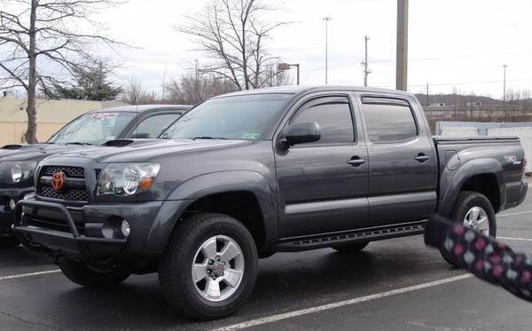

    So I did all my research (thanks everyone that helped) found what I liked for my 2011 TRD DC and jumped. First i ordered up the 5100's from DSM to level out after the tsb. Let that settle for a week then looked into 285/70-17's for my stock sport rims. Knew i was probably going to need spacers So I ordered up the Revo 2's and the 1.25 all-pro spacers. Tires won that race and came in next day. Called all-pro not shipped yet? So couldnt wait and mounted tires. There is nothing touching, rubbing or hitting anywhere. I'm still going to add spacers but im cutting them down. Heres the way it looks.
    THANKS again to everyone for doing great write ups on there trucks it really helped.
    after 5100 install set at 1.75, stock tires
    285/70-17's
    how it looks today, 1,018 miles total on speedo, 3 months old
    Hope this helps others. It rides awesome I love it.

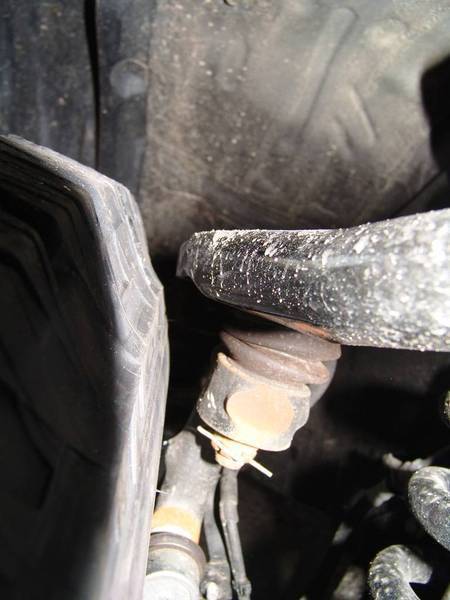

    How's the space between your UCA and the tire? I can fit my finger between my tire and the UCA.

    I can't. It's super tight. My spacers are in transit

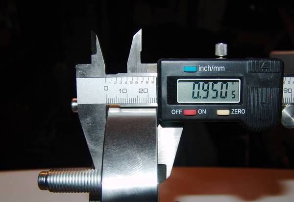

    i had pressure up that high just till the spacers came in. there in and i wacked them already. it came out perfect. i took .30 off both fronts and heres results. It's not even close to cab mount. Trimmings not a big deal correct but nothing hits.

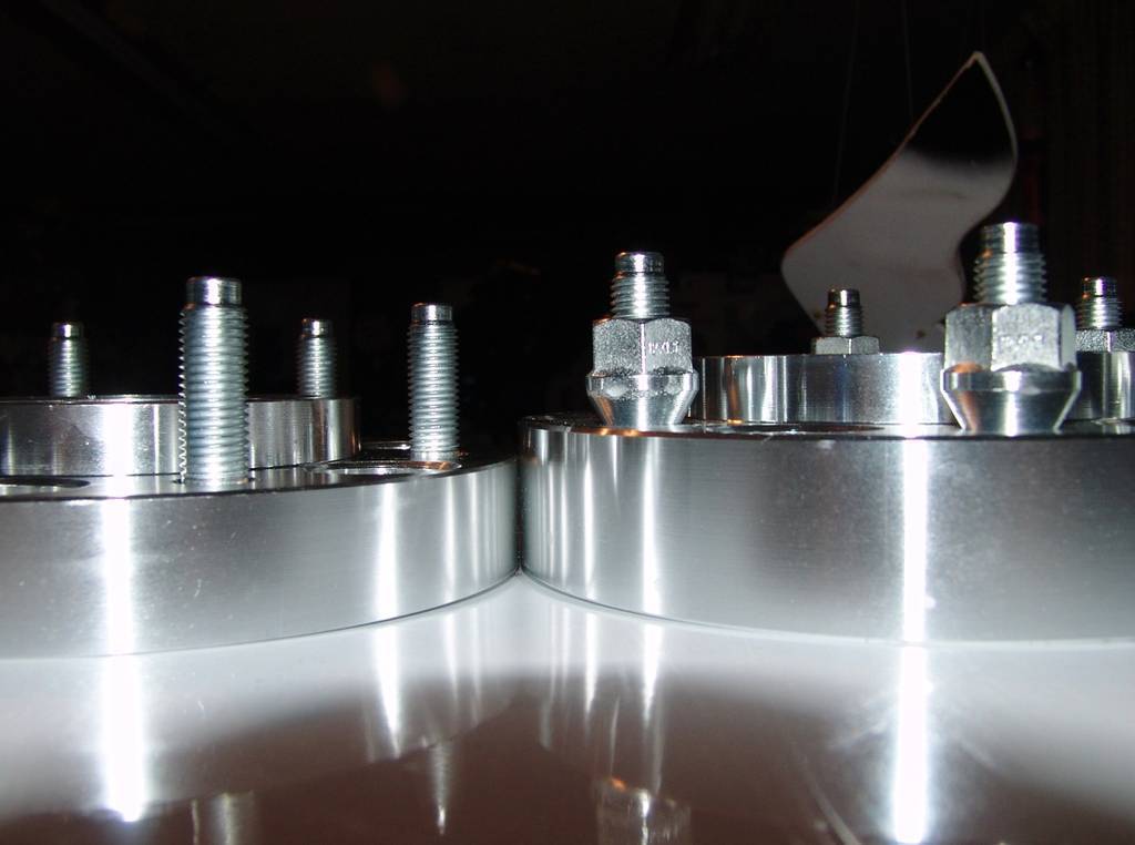

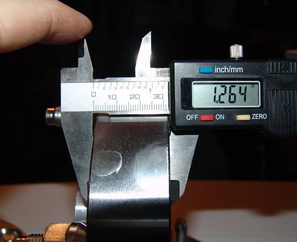

    Sorry for not responding had therapy. I cut down all 4. I didnt want them to stick out past fenders and i wanted just enough to safely clear uca. I tried to ask all the companies that made them for 1 inch but got runaround everywhere!!! and since hub centric was needed i couldnt use the only ones made in 1" from one place. The spacers put the tires right at inside edge of wheel well. I'll take pic when the crazy ass rain stops but here are more of spacer. The top pic from post #11 is stock they say 1.25 but thats the size i miked it at. so it was .014 off no biggie
