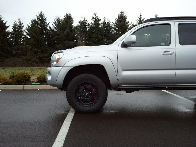

    I will take a picture in a little while. I have 1.75" 5100s up front with stock coils and wheelers 1.5" 3 leaf progressive AAL on Non TSB Springs. There is rake, but it's not bad at all. Less than the stock rake that the Tacoma's come with.

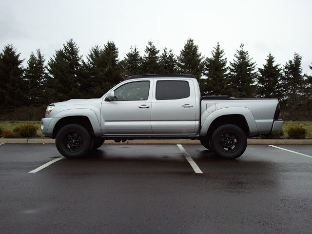

    Front: 5100's @ 1.75"
    Rear: Non-TSB Leafs, 5100's, Wheeler's 1.5" 3 Leaf Progressive AAL, and All-Pro U-Bolt Flip

    Finally took a better picture. 5100s @ 1.75" w/ 1.5" 3 Leaf Progressive AAL
