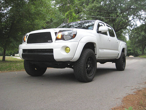

    IB Slingin
    IB Slingin Well-Known Member
    Sep 28, 2008
    #9535
    135
    This was my truck with the 5100's at 1.75 and the rear leaf TSB....
