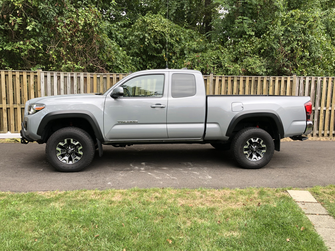

    I have searched a while and haven’t been able to find that much info or pics showing how 5100s (with stock coils) set on the 3rd perch (1.1”) with a 1.5 progressive add-a-leaf will look. My plan...
    I ordered a camper shell a few weeks ago and while I wait, I’m planning a small lift. In the end, I want the truck to sit 1” higher all around than it does now (and maintain that 1” factory rake)... after the shell is installed. The shell weighs ~200 lbs., which will sag the rear end ~.5” from what others have said. So...
    I’m thinking a 3 leaf progressive AAL (1.5” lift with factory overload spring removed) should net the rear ~1” lift over stock once the camper shell is installed, yes?..
    And that would mean I should set the front 5100s on the 3rd notch (w/ stock coils) for 1” lift over stock, right?
    I want to make sure I’m not missing anything, or that the lift heights that the manufacturers claim aren’t off from reality. Any pics of an AAL with a camper shell and/or 5100s on the 3rd notch will be helpful. Here’s a pic of my truck as it sits now, patiently waiting for it’s new shell to come... Thx!

    using the 5100's with a little more spring than OE, and leaving it on a lower (preferably bottom) notch will be a better option.
    kas2828 and brian2sun[OP] like this.

    This has been a frequent source of confusion to me as I read through threads on 5100’s: Bilstein says the front shocks are designed to be used only with stock springs. But yeah obviously lots of folks are doing otherwise, and tons of suppliers will sell you preassembled with many options other than stock.

    Why do you say that?
    I'm at the 4th notch (1.5") with 1.5" add a leaf and I like the ride much more than when I was stock on off road shocks.

    I agree lift coils are usually better than compressing the stock coil. But in this case, I don’t think a 1” lift is enough to hurt the ride quality (we’ll see...). I also feel like it’s too small of a lift to a justify buying new coils for. If I ever go 2” or more, I’ll buy a nice coilover setup. I have Toytec Alumas in my 3rd gen 4runner and love the way they ride on everything.

    Anything past the 3rd notch is un desireable, but the Toyota OEM lift kit is basically a 3rd notch 5100.
    Do it up.
    JJ Diablo and brian2sun[OP] like this.

    Toyota advertises the OEM lift as 2” in the front & 1” (block) in the back... Wouldn’t that be more like a 5th notch 5100?

    Exactly. The harsh ride on notch 4 and 5 with stock springs is pretty much disproven. I’m on 4 and absolutely love the ride, and quality for the price point is amazing.
    OP, ive got 1.5” up front and 1” in back (leaving me with .5” or so of rake) and love the slight rake fwiw

    I have the 5100s all around with OME 887 springs in the front. It has given me close to a 2.5” lift. Also going with the same leaf setup. Not sure about adding the AAL with the overload leaf or take out? I don’t keep much weight in the back besides my softopper on the regular. Does see about 150-200lbs when camping. That’s why I went with the AAL. I try and keep my Tacoma as light as possible.

    Bilsteins 5100s on the top setting, 4runner Gray TRD Pro Sema wheels, 285/70/17 Toyo AT3s, Sumo Bump stops, TRD exhaust, ECGS Clamshell bushing, 1/4 shim for the lean and one inch rear block, OEM Pro grill and garnish OEM TRD Skid plate, TRD CAI, Demon Brackets, Rigid Industries Pro fog lights, OEM Trail Rails sidebars, Diode Dynamics LED SL1 high and low beam lights, OEM Roof racks, Clazzio leather heated seats, Remote Start, TRD Pro shift knob, tinted windows, Rockford Fosgate 4 channel amp for the headunit and sub and amp combo, OEM Puddle lights, OEM tailgate lock, OEM bed mat, LED interior lights, OEM blackout kit for letters, JLT catch can, upgraded 27F toyota True Start battery, Vleds led tail light kit with Pro tail lights, OEM Rave4 side mirrors with convex spotters,just to name a few mods.
    5100s here on the 4th and a 1 inch block on my DCLB with an ever so slight rake and our other one is a DCSB set on the 5th with a 1 inch rear block and its dead level. Your not compressing any coils which a lot of people are misled about that, the ride doesn't change either which confuses people as well. Keep your factory coils as OME coils are known to sag and Bilstein designed the 5100s to be used with the factory coils and by doing so it keeps the Bilstein lifetime warranty.

    I installed the TRD OEM Lift kit shocks with a 1.5 - 2" Torch AAL in the rear. Did not use the 1" lift blocks. My front shocks are set of the third groove for the maximum lift (2"). I also have an additional 142 pounds in the front end; Body Armor Hiline bumper with a 12K Harbor Freight Apex winch:

    I’ve seen the debate around here about whether the coils get compressed or not with 5100s (honestly, it’s only a debate to people who don’t quite fully understand how the strut/coilover works). Think about this... the actual extended length of the shock can’t possibly get any longer. So when you move the collar up the shock, the area where the coils is “trapped” gets smaller while more of the shock body below the coil is exposed (which makes the coil stiffer, which equals more lift... but the overall extended length of the strut always stays the same). That means the coil get compressed. Imagine if you could keep going up with the collar?.. Eventually the spring would be completely smashed with no room between the individual coils. That’s compression.

    Basially, most 3 leaf AALs will give you 1.5” w/o the overload, or 2” with the overload. Most people say the ride is a little stiffer with the overload left in.

    This is not correct.
    Spring holds truck.
    Doesn't matter if the bottom of the spring moves up or down, it compresses based on weight. Unless you add weight the spring compresses the same.
    The amount of possible travel will change based on the setting and components.

    So the more you move the collar up, you don’t think the space where the spring is contained gets smaller?

    OP you could do 4th setting front and rear 1.5” aal your good. Ride is great. I’ve since upgraded but you can’t go wrong with 5100’s.
