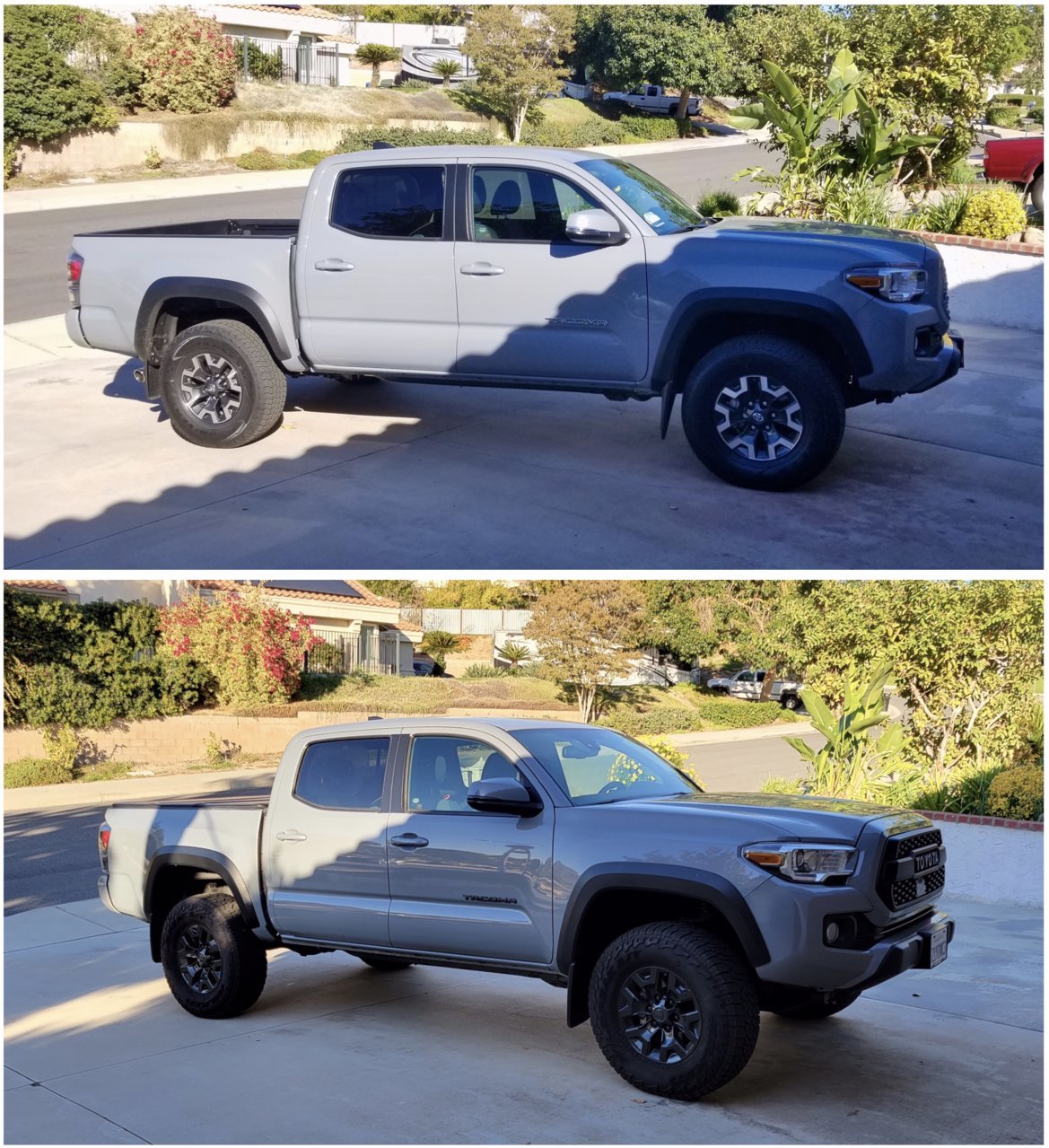

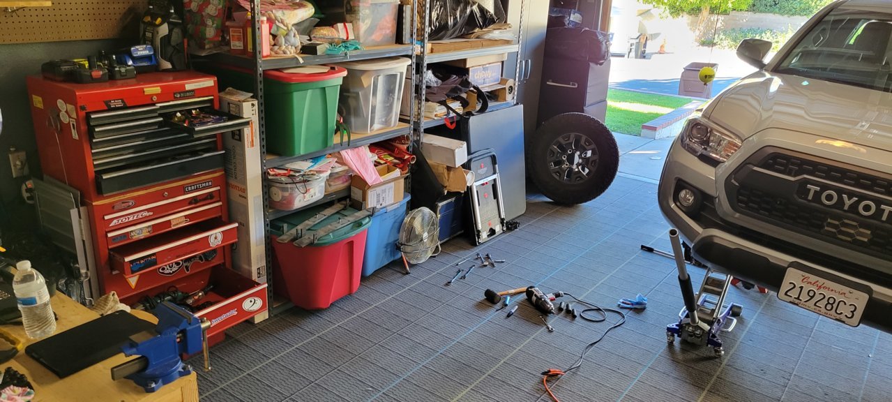

    I ended up not getting 5100s. I like the factory ride of my truck and since it only sees the occasional dirt road and some snow in the winter, I really didn’t want to spend $250 on brand new shocks for just a 1” lift. My OEM shocks have 8500 miles on them and still ride great. So I decided to keep them and bought some Streetrays .5” thick aluminum top plate spacers (for 1” lift) for $35. They come with new nylon lock nuts that are about 2/3 as tall as the OEM nuts, so you use your existing upper shock bolts, and you don’t have to compress the springs to take the coilover assembly apart, etc...
    So today was lift day! Took me about 6 hours to knock out the front and rear by myself... and that was taking my sweet time with a couple beers involved. I can confirm the OEM front upper shock bolts are long enough to get these spacers in, and install the supplied lock nuts on safely. I’m not usually a fan of spacer lifts, but I’m ok with this one for a super cheap and super easy 1” lift that works. I saved over $200 not getting new shocks and I’m happy. I would not go any more than a .5” though personally. Anyway I ended up getting 1.1” of front lift out of the spacers, as measured right before and after install.
    I also installed a 1.5” Headstrong 3 leaf progressive add-a-leaf today. Headstrong’s design is pretty nice, you don’t need to cut the rear shackle off the stock leaf pack with this AAL. Install went nice and easy. I ended up with 1.6” of lift in the back, so I have a 1.5” rake now and that’s good for me. I’m getting a camper shell put on in about a month that weighs like 200 lbs. So that’ll probably sag the rear ~.5”, and put me back to about a factory rake with the 1” lift all the way around, and the shell on. And then I’ll be able to still haul a couple hundred lbs. of work gear around without the bro lean.
    I took one pic today while I was installing everything...
    And here’s a pic of the truck bone stock with the cheap OEM Goodyears (top), and after the lift w/ 265/75/16 Wildpeaks. I’ll update the thread again when I get the camper on...
