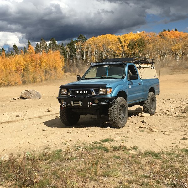

    image.jpg I'm on a very small budget. I'm rocking rough country shocks (oem length) with old man emu 2881 springs and an add a leaf out back. Gave me a leveled look and about 2.5" of lift up front. Only 200 bucks or so to lift it too! The pic show my 32" mud terrains.

    That's a great looking single cab, Jacob! I really like that color, though I think in general most folks don't. Or I'm confusing it with a different color that folks seem to frown on. Regardless, your tacoma has a killer stance and it suits the single cab very well. Plus I love the steelies, awesome choices man. What vehicles are your steelies from?

    The steelies are factory fj 17". The tires are 255/75/17 km1s that came on rubicon jeeps from the factory. The paradise blue metallic color is hella rare (only 2.5 years), and it grew on me. Impossible to lose in a parking lot

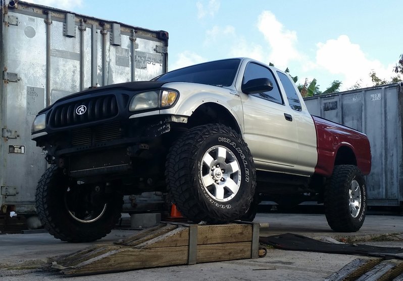

    Upgrade to the 5100's for now since you probably need new struts anyways. I'd add the ome coils later but focus more on getting the ride smooth and finding tires.20160416_165428-1.jpg
    This is my truck with factory TRD Bilstein's and ome 881's on 305/70R17's. If it's just the weekend truck, I'd cut the fender to clear whatever tire size you want. But that's just me
