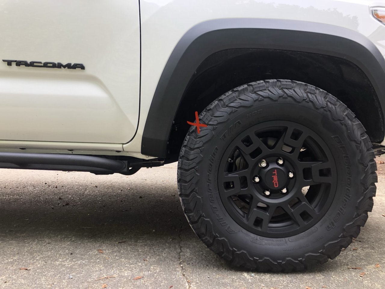

    Adding a picture - contact is made at roughly 10:00... seems like a couple inches would make a difference with the rub (** that's what she said!).

    Upgrading your shock may or may not solve your issues. I would personally go see an alignment shop and get that caster pushed forward a 0.5-1 degree more.
