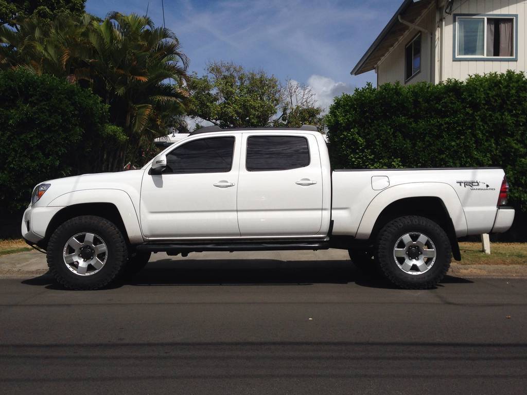

    Yes I measured from hub center to bottm center of fender. Here's how he sits on a level surface. At first I didn't think much of it but when I'm side by side with fellow members me rake is more noticeable. And I emailed ARB 4x4 about the 885's and they said that 1.5" is what I'm supposed to get with them as they're supposed to only be used with OME struts. So, I have no warranty claim. So, if that's the case is it still preloading if I'm sitting so low to begin with and I set the billies at .85? If it is can I get 3/4 top spacers with the 1/4 lean and still stay with my stock uca's?

    You are supposed to get 2.5" :confused:
    That's bull shit what they are telling you

    By ARB / OME literature , you are supposed to get 2" with up to 120 lbs up front , most here get 2 1/2"

    First off. Nice looking truck man!
    Yikes. Yes it looks like you are stuffing those ??285s?? On level ground.

    I'd be a bit irritated myself. Just looking at the pics it's so obvious.

    Arb is being full of shit right now and that sucks. They need to send the right damn coils. They know they screwed up and now don't want to admit it. Someone put the wrong sticker on the wrong springs. Had to.

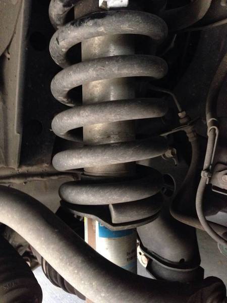

    Hey guys what about my spring perch? Could I have it upside down? Which way does yours face if you have 5100's? I bought them used so was thinking I may have put them together wrong...?

    Well I think it's different on the ome vs 5100's but my perch is up like a reverse bell

    Here's mine and the bell is facing down. So I'm trying to see what everyone else has. Makes sense to be facing up. But I don't know.

    That's right for 5100's
