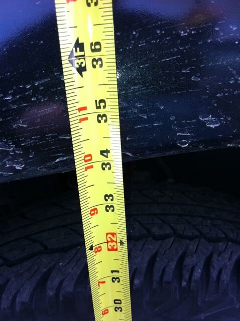

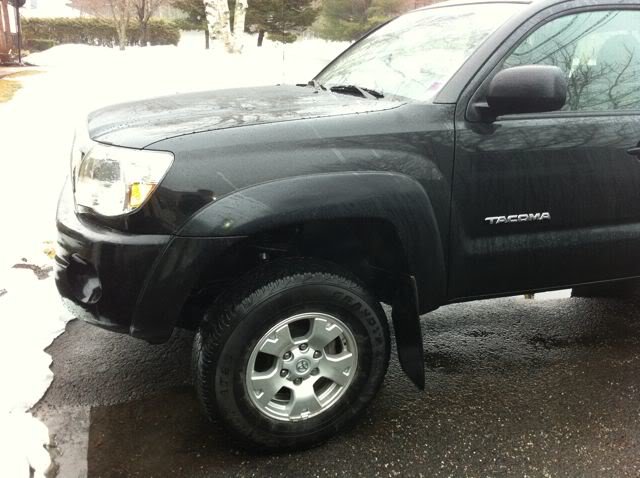

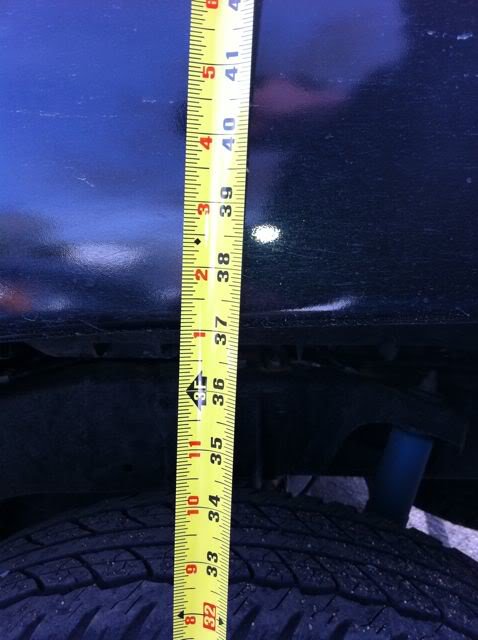

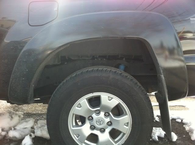

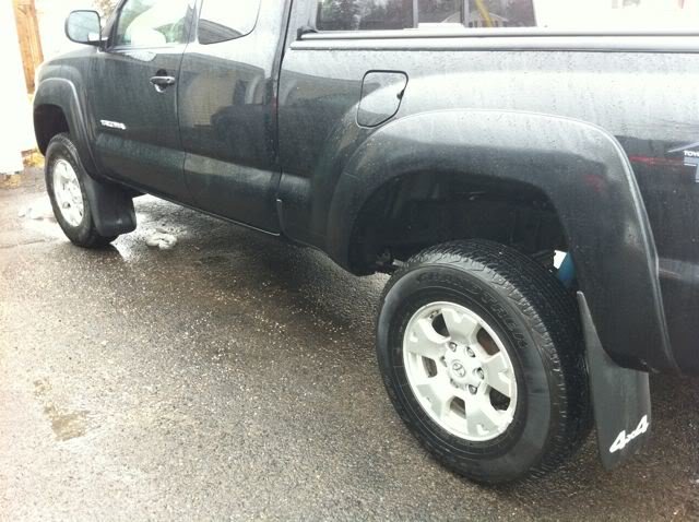

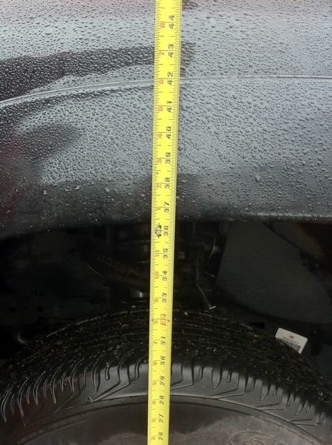

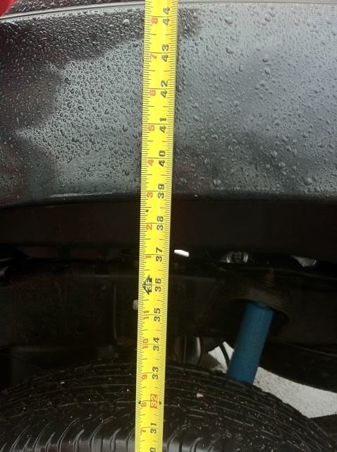

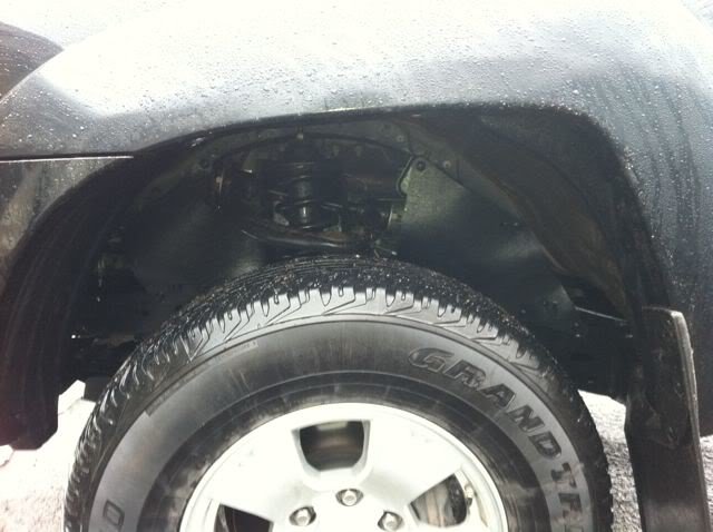

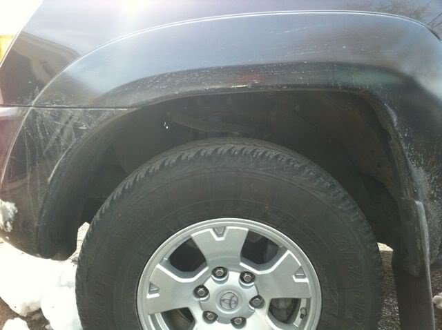

    Here are some before and after pics.
    I had 5100's set at 2.5 installed on the front and the 1.5 AAL on the back (5th leaf added to my Canadian 4 leaf pack).
    I got a full 2.5 on the front and 1.5 on the back. Very happy!!!
    Front before with measurements.
    Front after with measurements.
    Back before with measurements.
    Back after with measurements.
    Front picture after.
    Back picture after.
