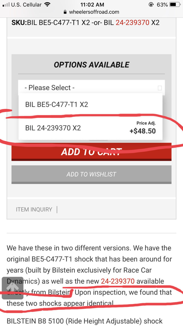

    Getting ready to order 5100s. I am finding 2 different part numbers for them tho. Wheelers off road has a $48 option for the 5100s but it says they can’t see any difference.
