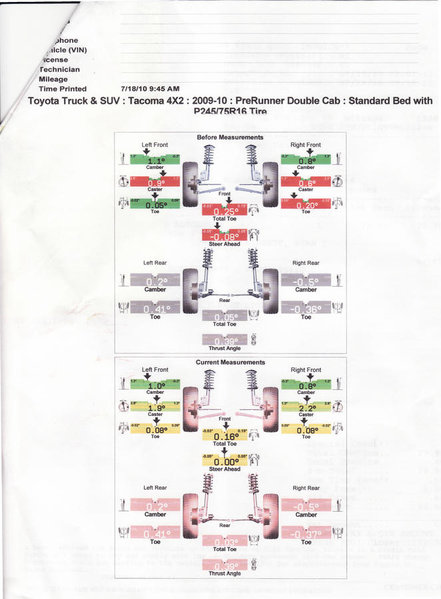

    Here is mine. I will have it done again once I let them settle in some more.

    ^ Maybe I'm just being over parnoid, I dunno. From looking at yours mine doesn't look to bad either.
