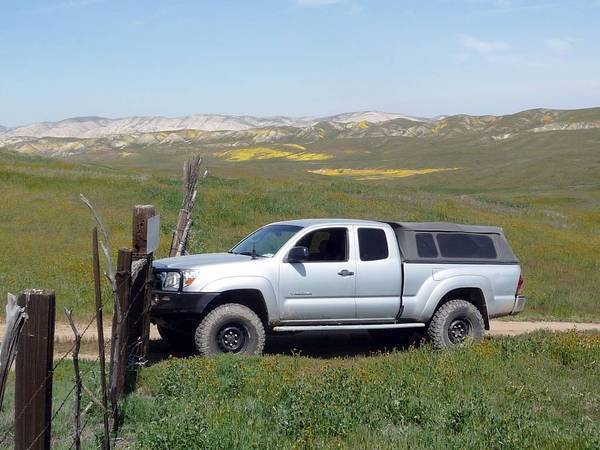

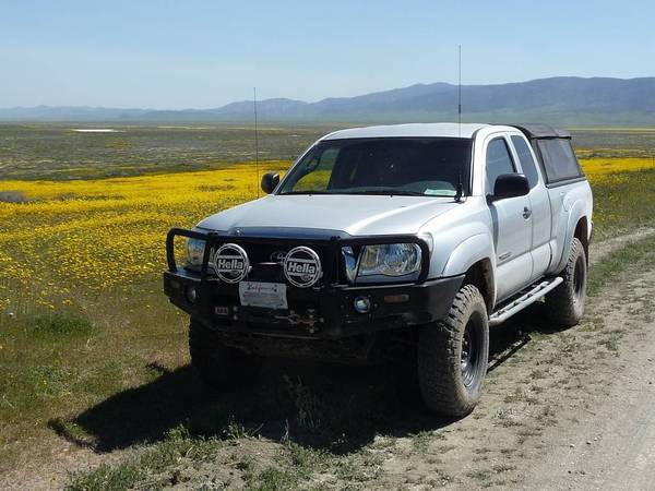

    just a couple comfort items.
    Here are a couple more 255/85/16 pics

    Very military issue looking... I like it but only a 4x4 could pull it off.

    Will they fit on the stock wheels ? And do you need to do any trimming ?

    If your stock wheels are 16s they will fit. As for trimming yes you will need to lose the mud flaps, beat the pinch weld down and do some trimming at the rear of the wheel well . Depending on how hard you use you truck you may want to extend your bumpstop a little. I found my tires were into the top of the wells on a good bottom out.
