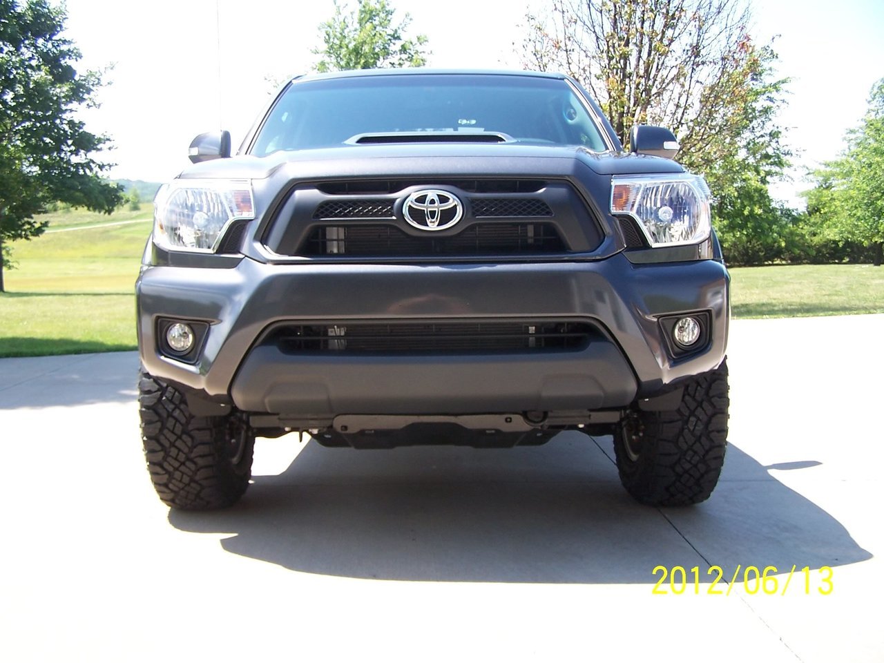

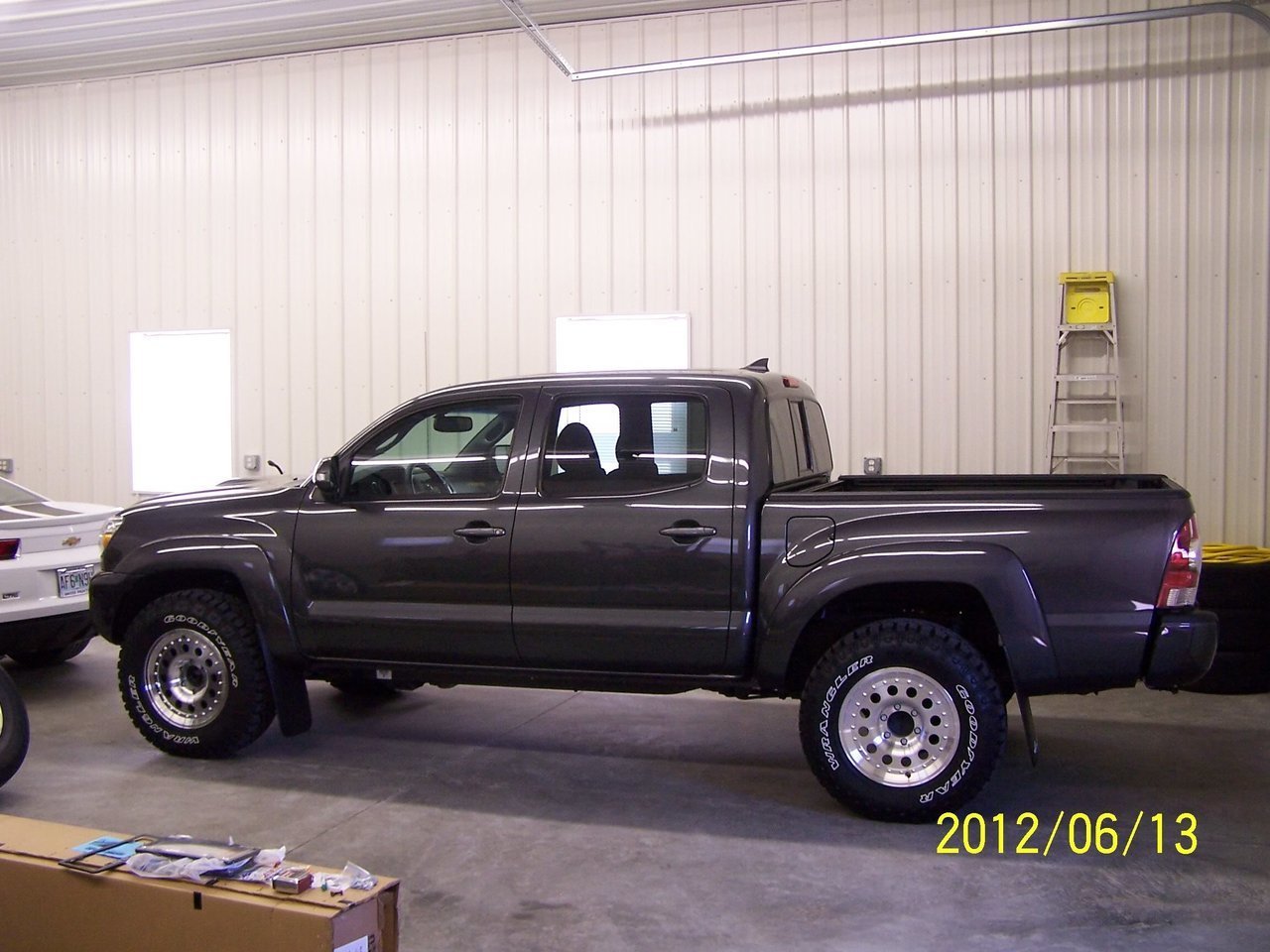

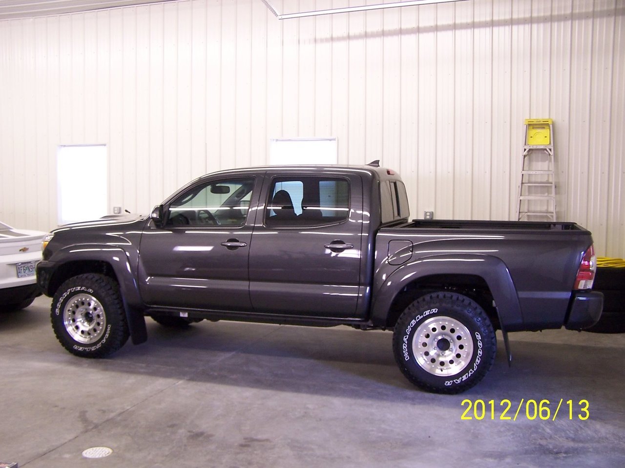

    2012 Sport 4x4 DCSB. Truck has only 900 miles. It does have the 4 leaf spring pack straight from the manufacturer. Just installed my 5100's set at .85 and got right at 1.5" lift in the front with the stock coils. Does this seem right? I was debating between .85 and 1.75 to just level the truck or keep just a little rake. I'm glad I went with .85. I know the shocks are set at the 2nd adjustment (.85) and the coil seats are not upside down. I like the look, but wasn't expecting quite that much lift at .85. Here are my measurements (ground to fender on level surface).
    Stock coils, stock shocks, stock rear springs, stock Bridgestones (32 psi):
    LF = 34.50"
    RF = 34.75"
    LR = 36.75"
    RR = 36.75"
    Stock coils, stock shocks, stock rear springs, Duratrac 265/70/17 (35 psi):
    LF = 35.25"
    RF = 35.50"
    LR = 37.50"
    RR = 37.50"
    Stock coils, 5100's set at .85, stock rear springs, Duratrac 265/70/17 (35 psi):
    LF = 36.75"
    RF = 37.00"
    LR = 37.50"
    RR = 37.50"

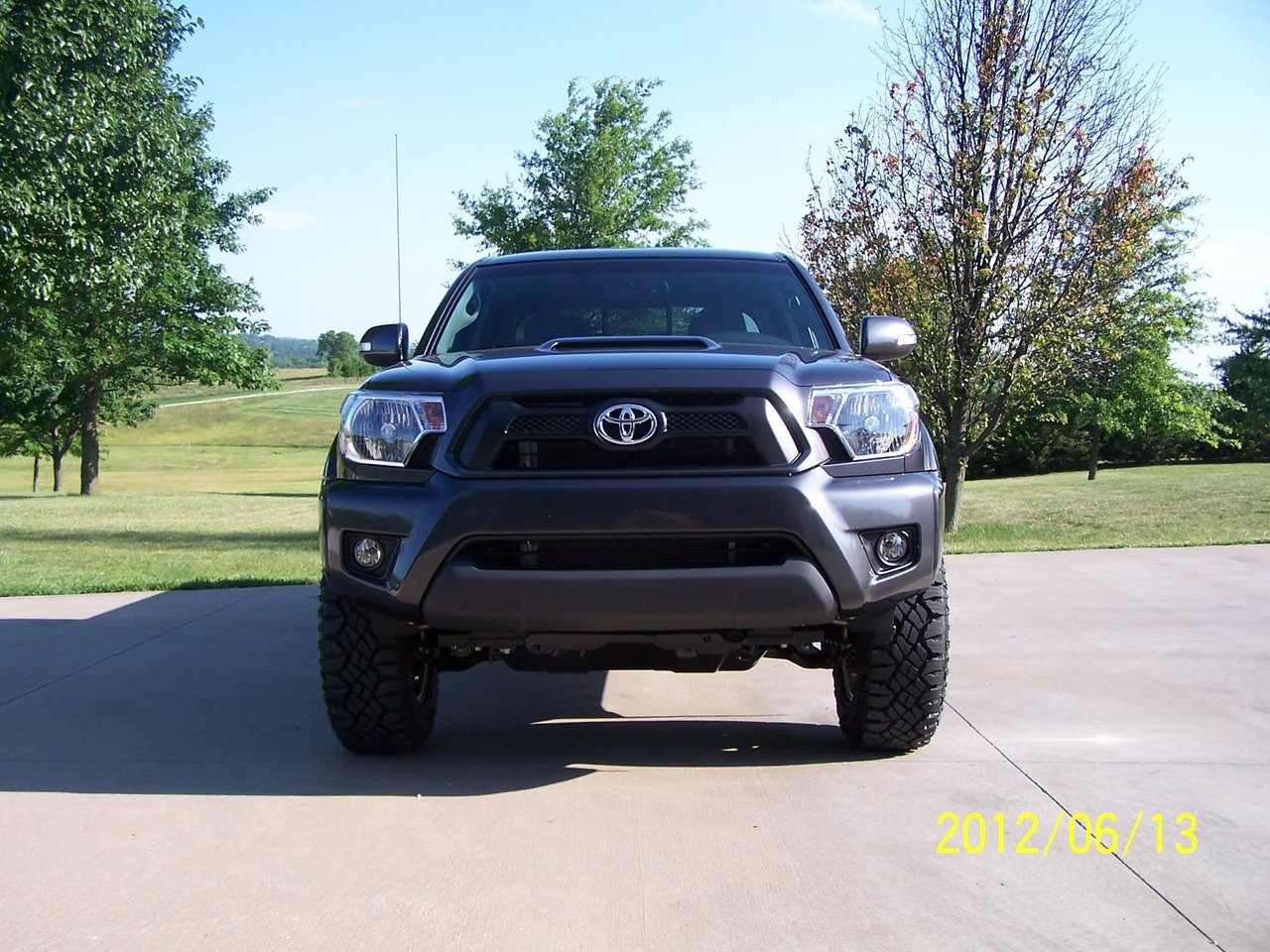

    So, bottom line, I got 2.25" of lift from 5100's set at .85 (1.50") and 265/70/17 Duratracs (0.75"). CV's changed a little, but not too bad.

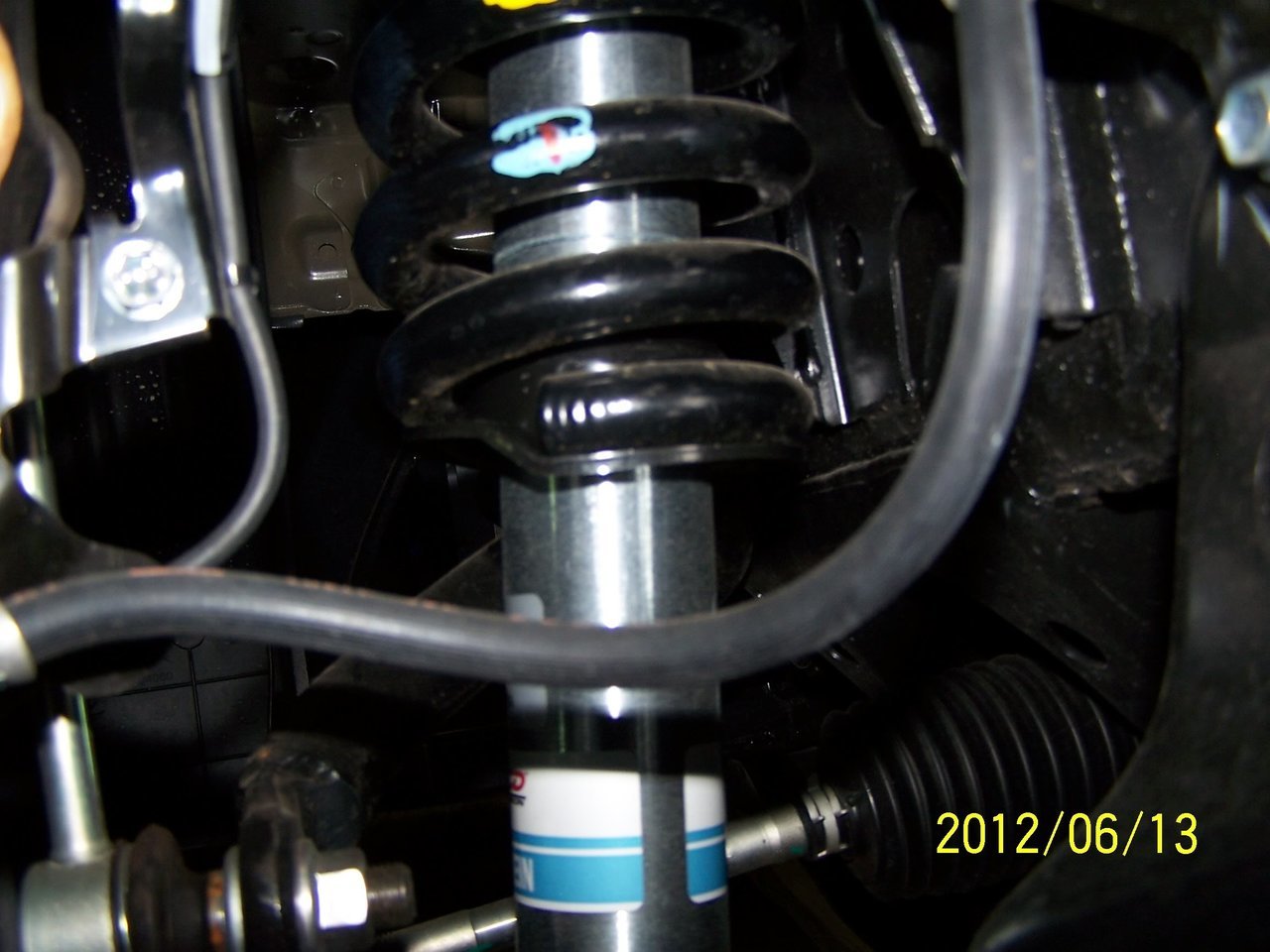

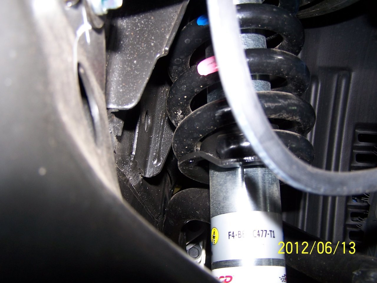

    Before
    After

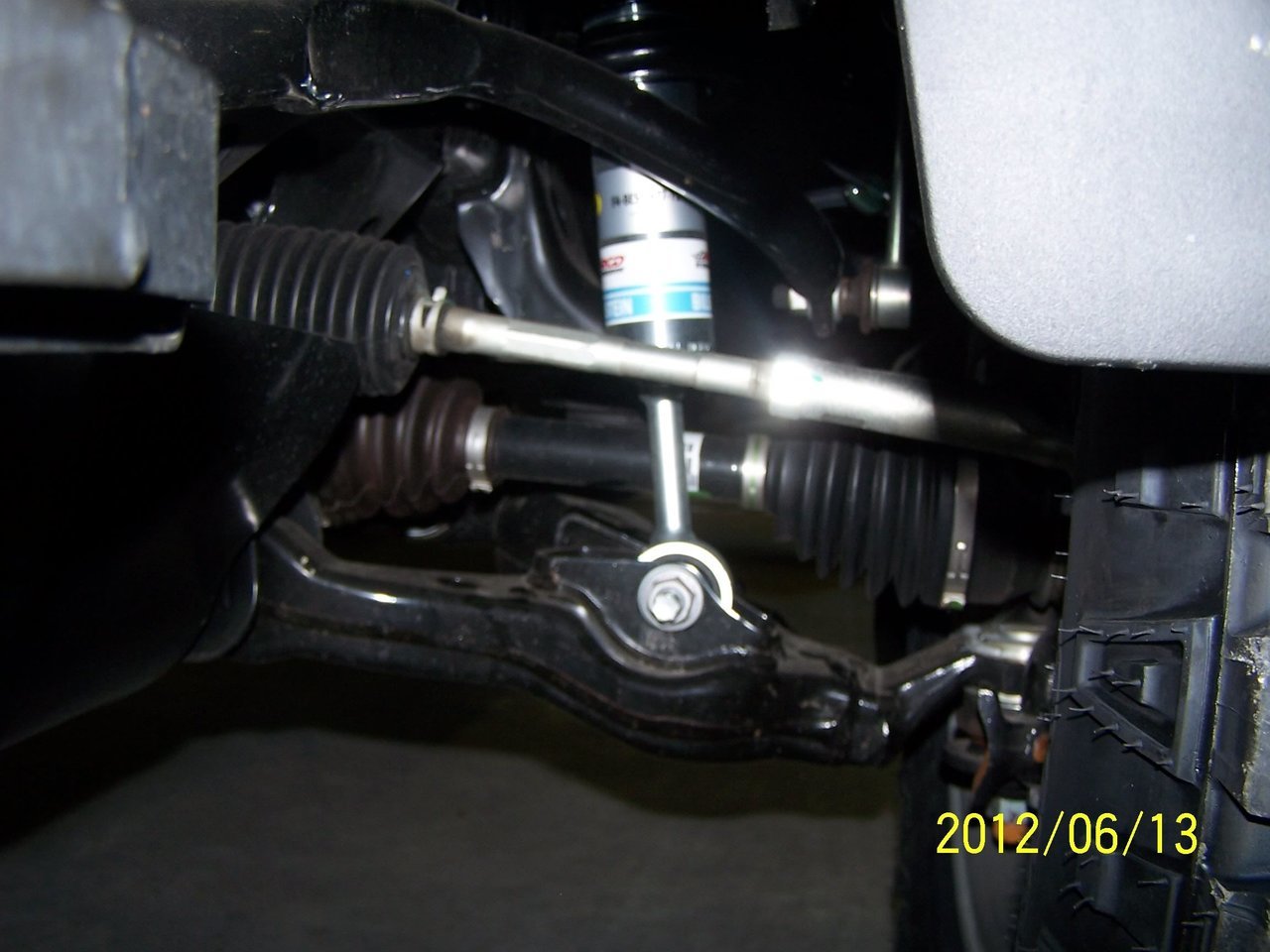

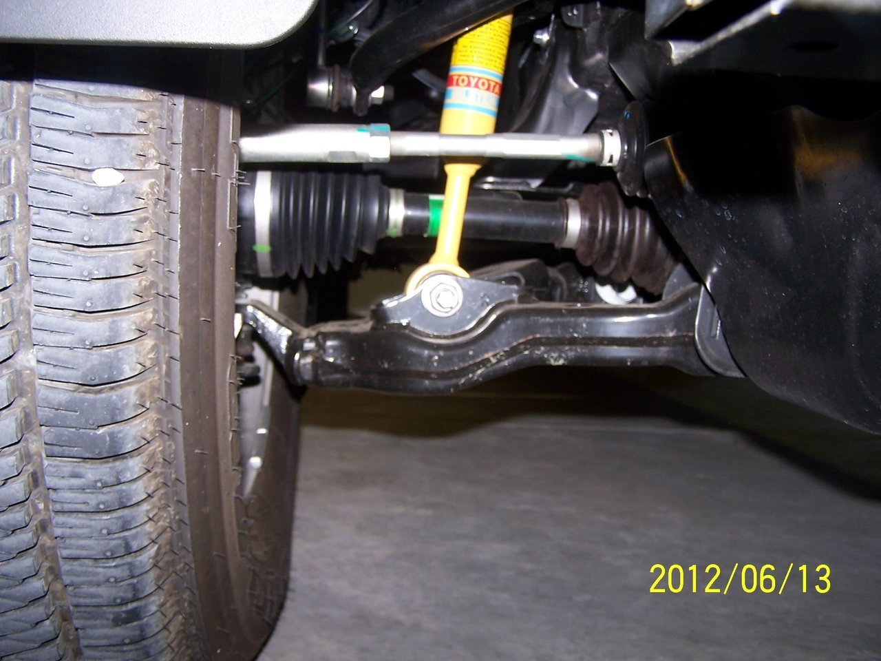

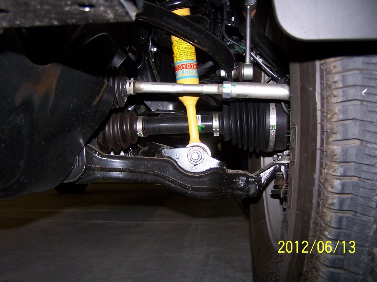

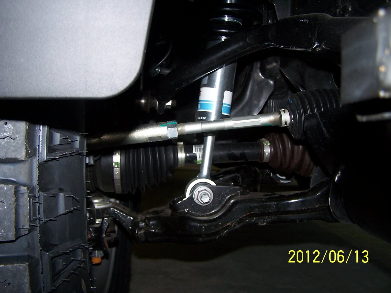

    One other question. To the naked eye, camber looks fine. Truck also drives perfectly straight on the highway. It doesn't wander or pull to either side. Do you think I should still have my alignment checked? I'm really happy how it looks, rides, and drives.
    Before 5100's
    After 5100's

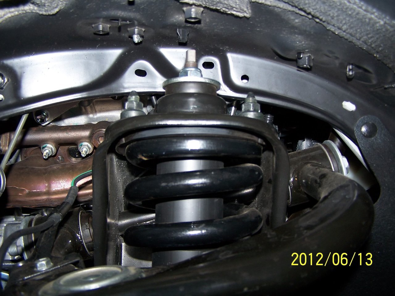

    the spring seats might be up side down

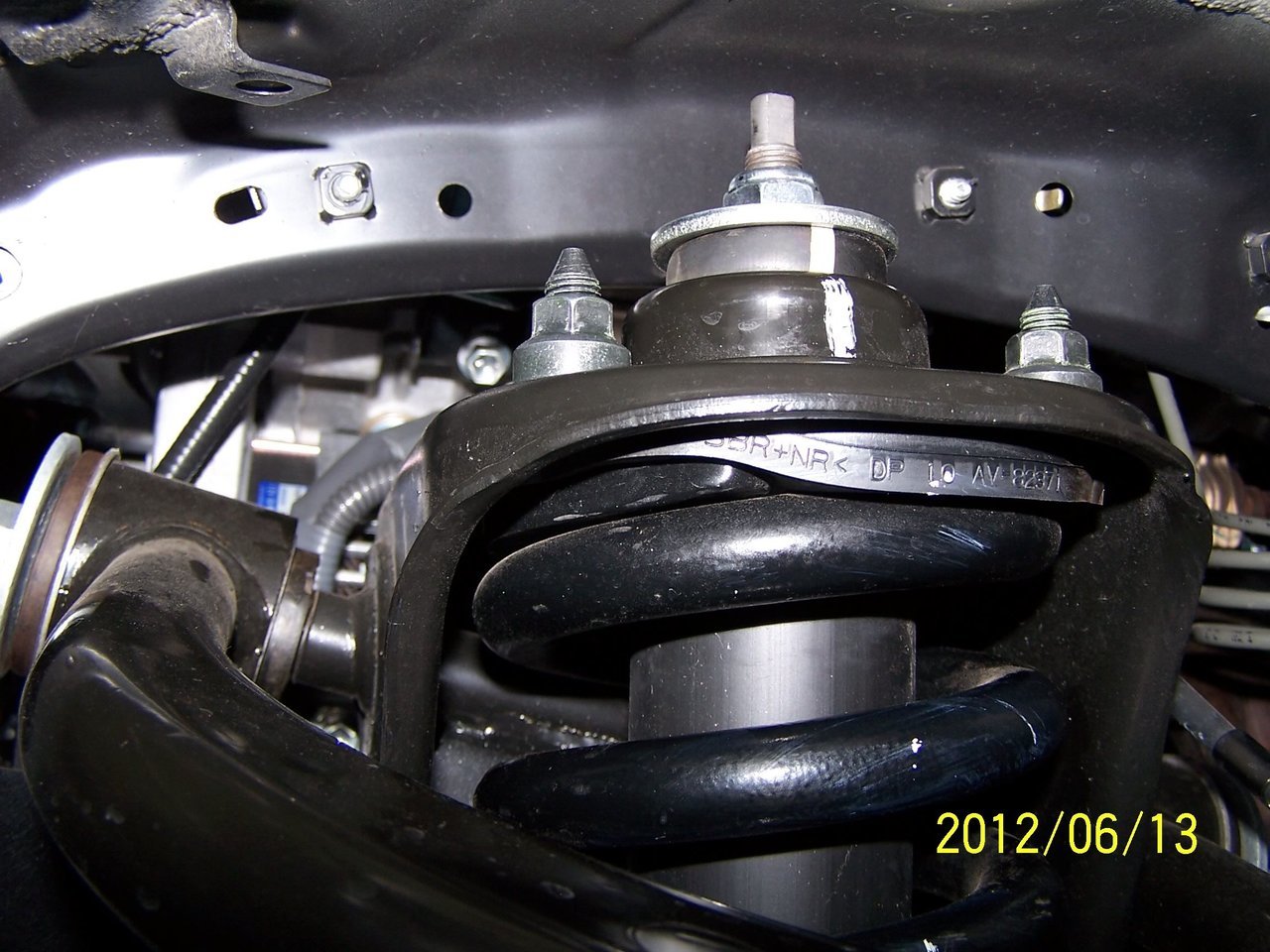

    As I mentioned in my first post, the spring seats are not upside down. I was very careful to make sure they were on correctly. After I measured the 1.5" gain, I double checked again. I am sure they are on the correct way. Here's the best pics I can get without removing the wheels.
    Driver's Side Coil Seat
    Driver's Side Top
    Passenger's Side Coil Seat
    Passenger's Side Top
    Could I be missing something with the way I'm measuring? Just makes sense to me that ground to fender (before 5100's and after 5100's) would be the lift achieved from the shocks. I've double double checked and they are set at .85. I couldn't really get a pic to prove that.
    As far as the ride, it's more firm and doesn't shake as much when you hit a bump (like going over a bridge or something). It just feels more stable, if that makes any sense.
    Since it seems to drive straight (no wandering or pulling to one side) should I still get my alignment checked?

    Thanks. I didn't think I had them on wrong.
    I just went back out and measured center of hub to fender. I had also measured this way when it was stock. Stock showed 20.25" on LF and 20.50" on RF. It's now showing 21.75" on LF and 22.00" on RF. It's 15.00" from ground to center of hub. It all adds up. I'm getting 0.75" from the larger tires (old ground to center of hub was 14.25") and 1.50" from the shocks set at .85. Is it unusual to get this much lift with the 5100's set on .85 with the stock coil springs? It's only been driven maybe 20 miles. Could it settle any?
