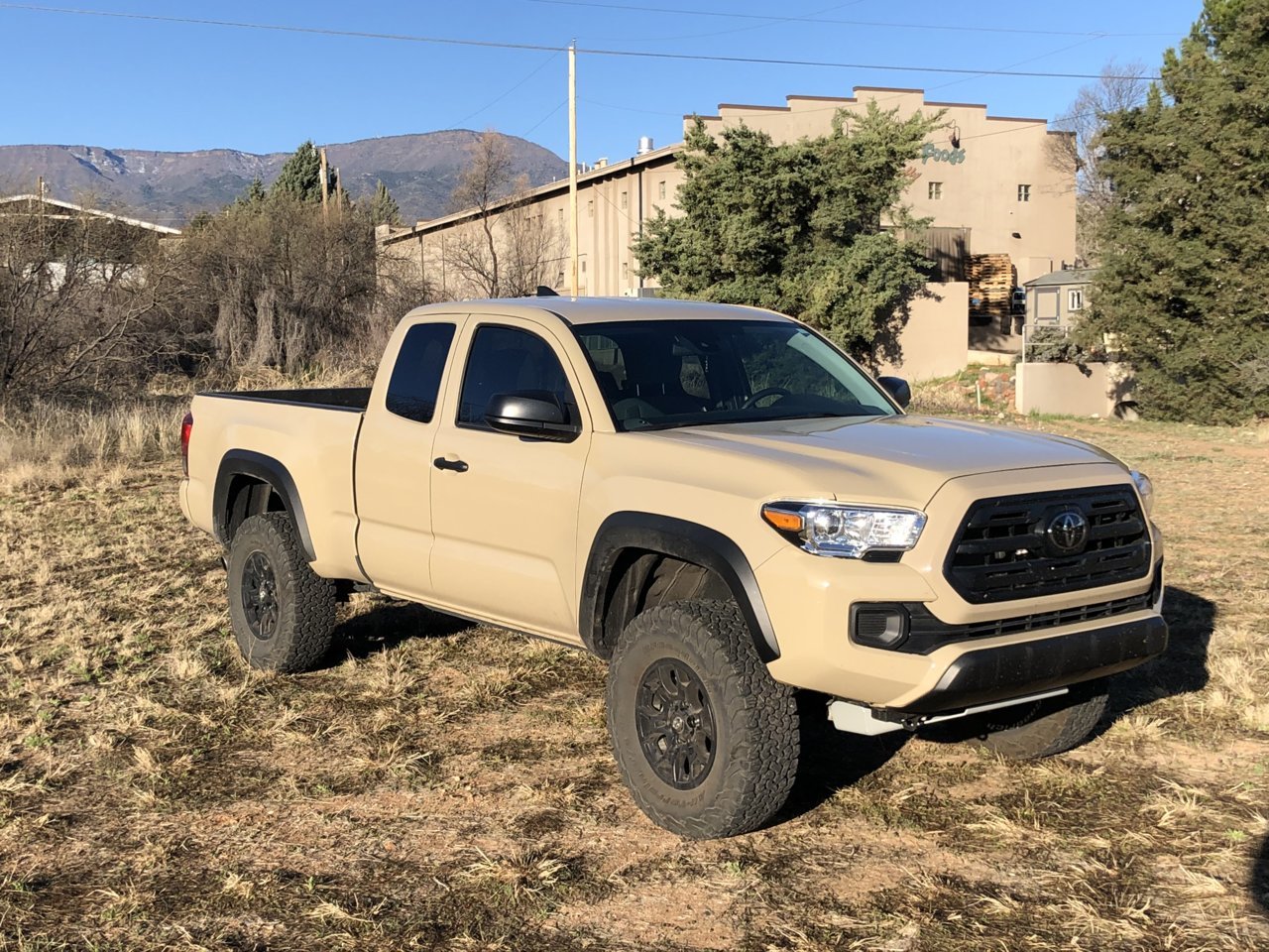

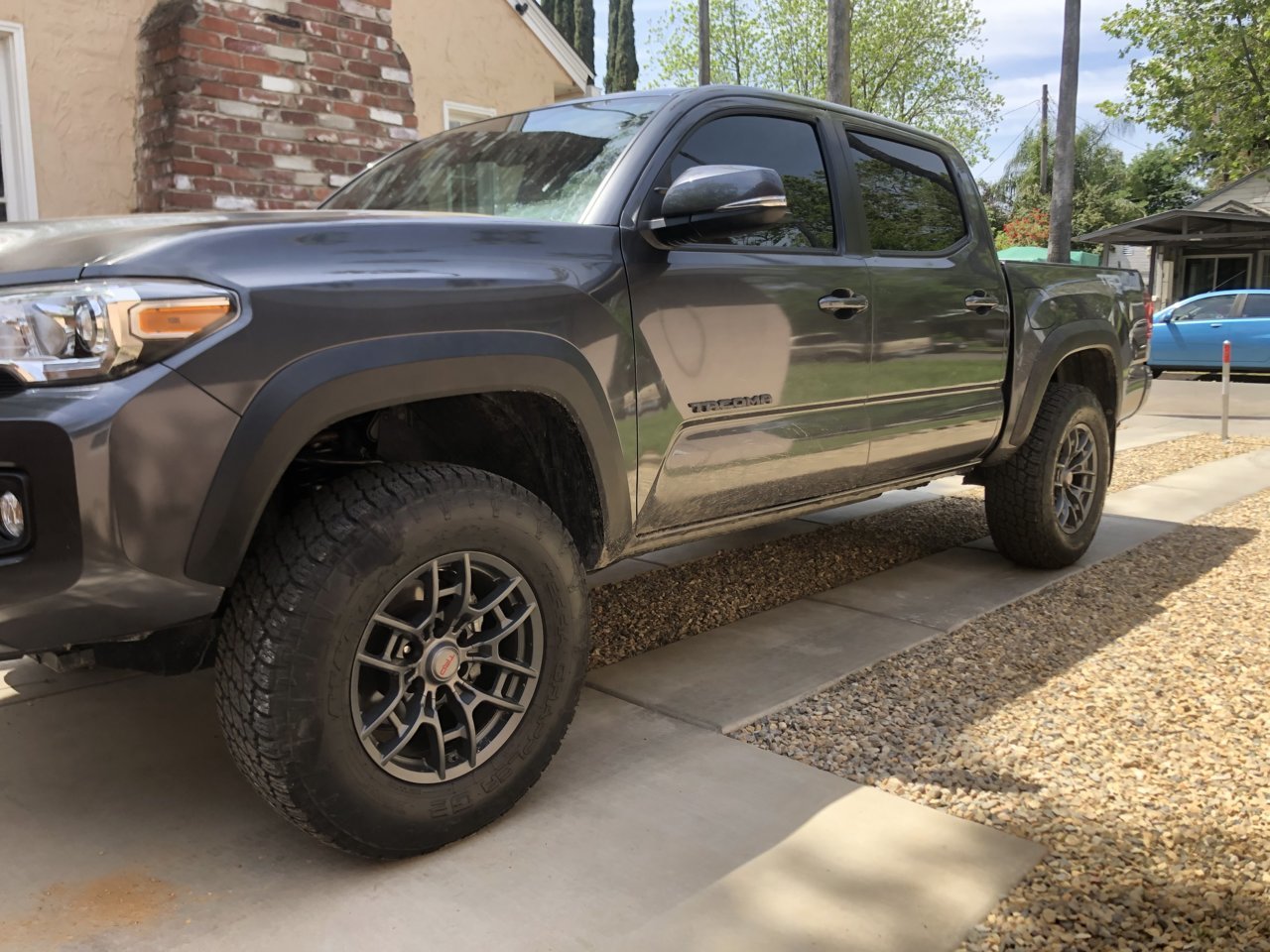

    I went with the 6112 in the front, with a diff drop, 1/4” spacer on top of the strut. Set to #5/#4
    5100 in the rear with a 1” block.
    265/75/16 K02 Load Range E1. (Stock tire was a 245/70/16 load range C)
    The lift and tires netted me 3.5”over stock height, and it sits level.
    Not the best before and after pics, but it’s the best I have got.

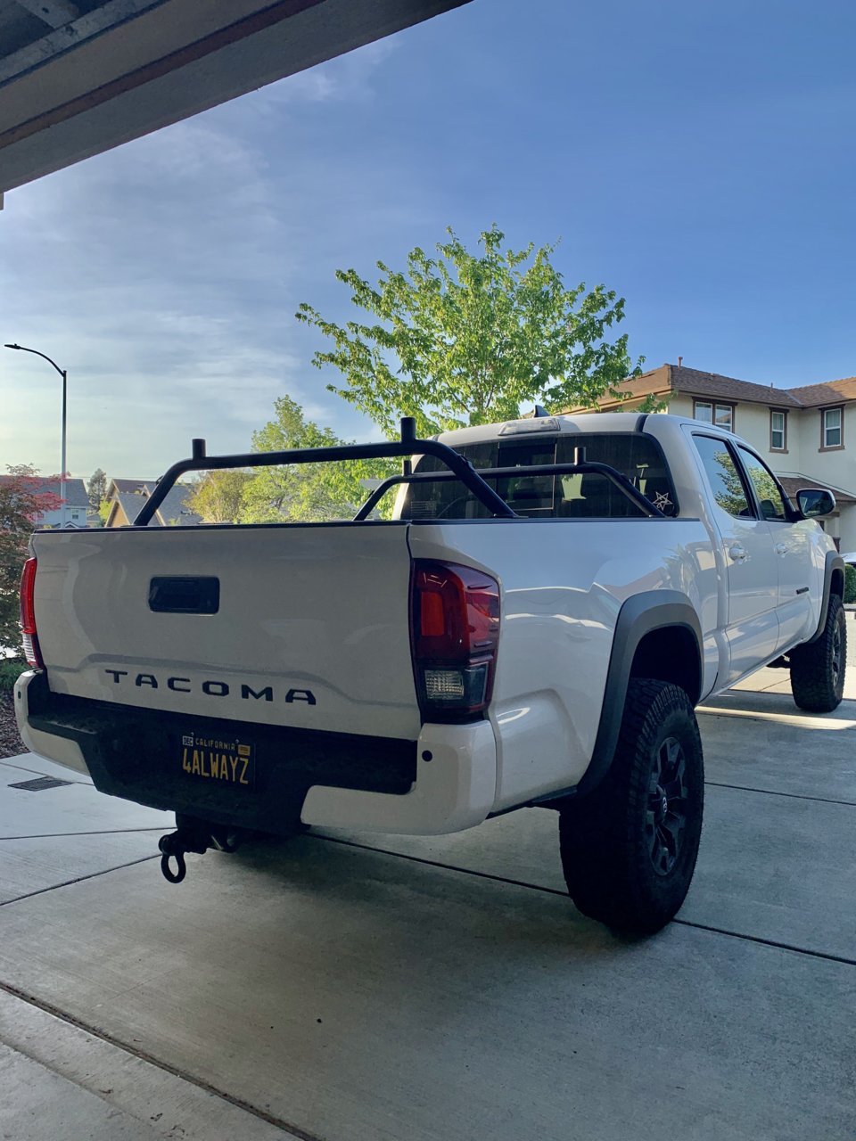

    Here you go
    BrassEnthusiast1 and mgmdclb like this.

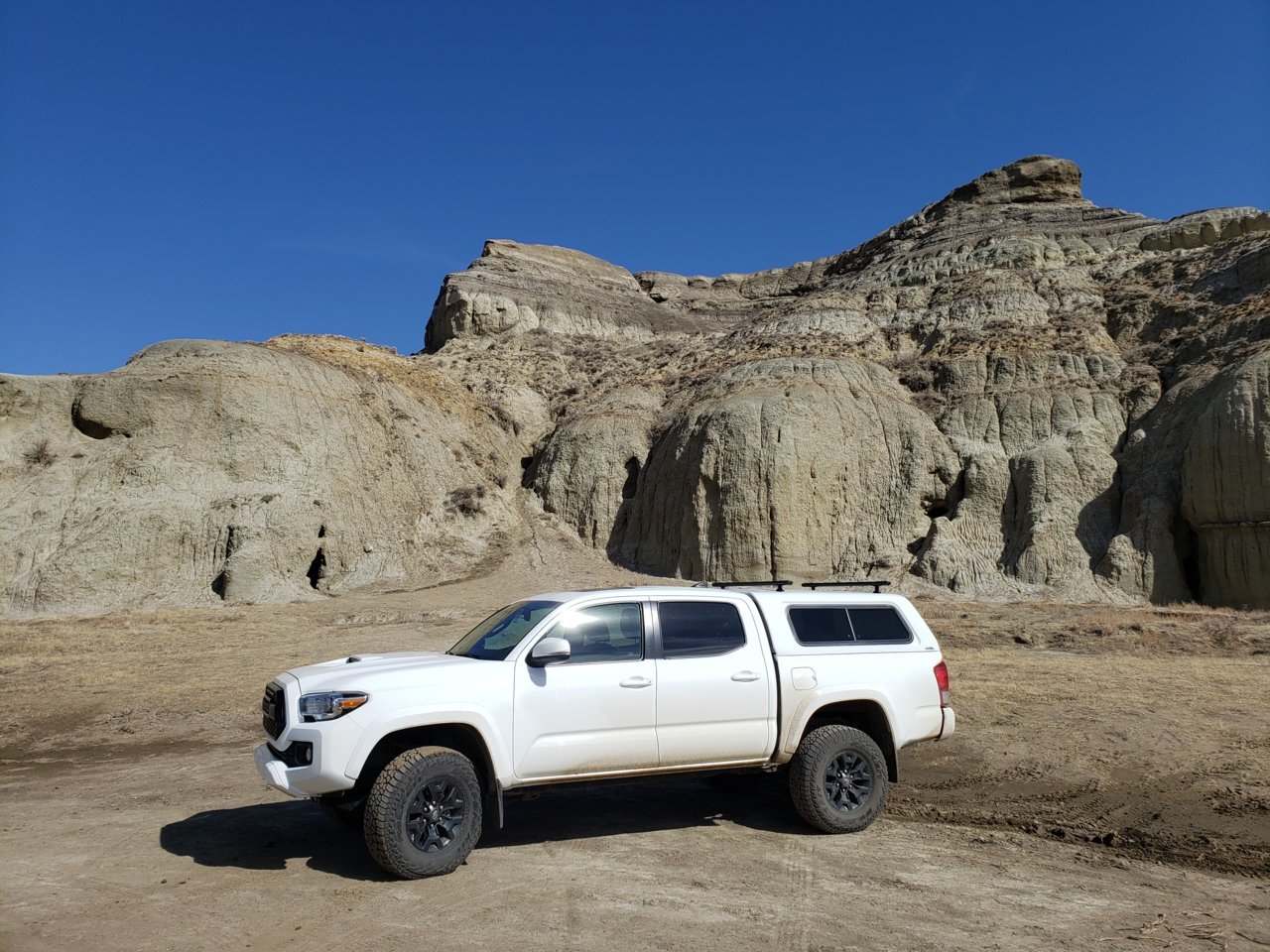

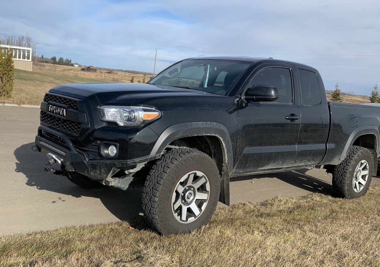

    5100 4th notch , wheelers 1.5" aal in the rear, 265/75/16 tires
    71tattooguy likes this.

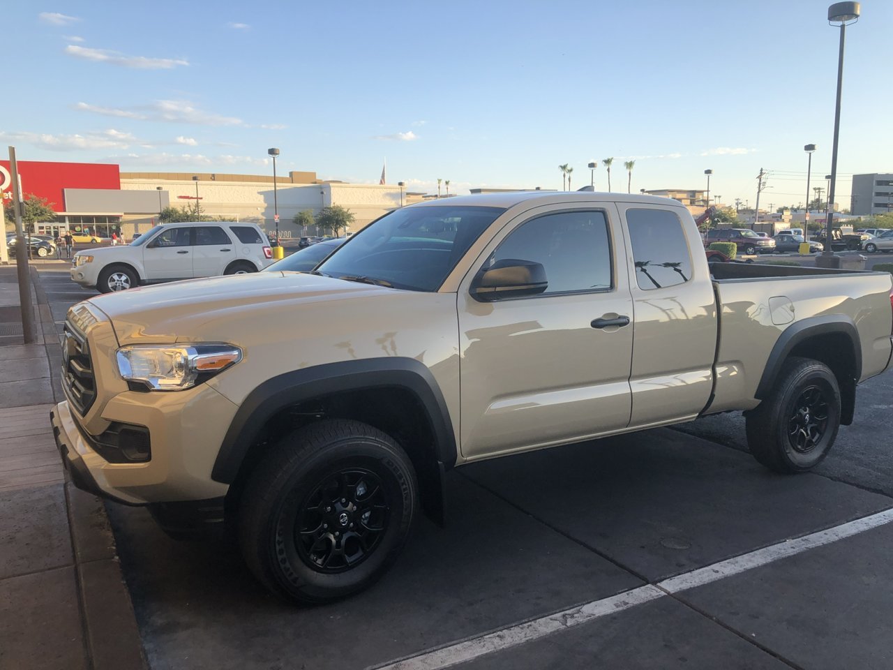

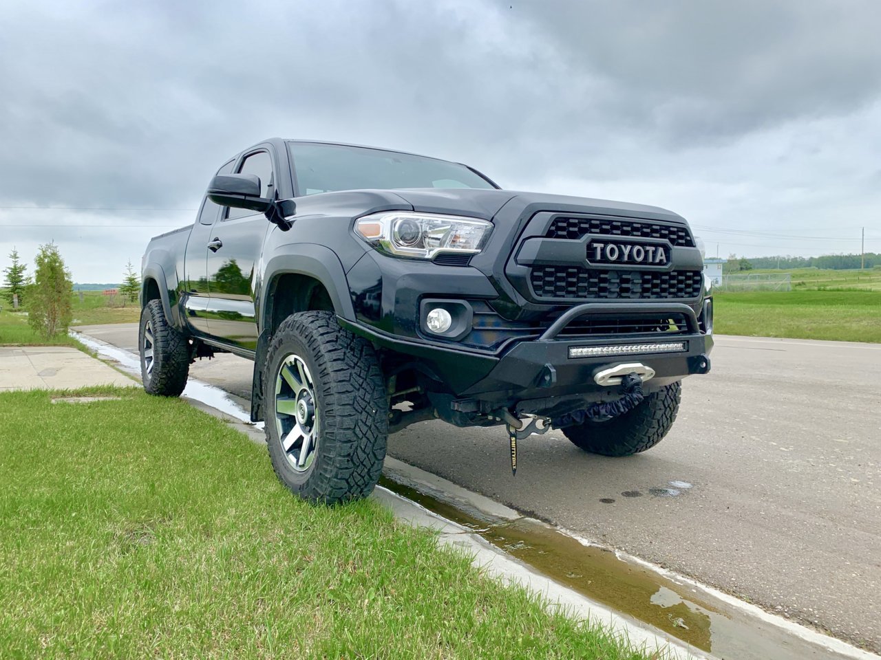

    For what it’s worth, 5100s up front and AAL in the rear.
    255/75/17

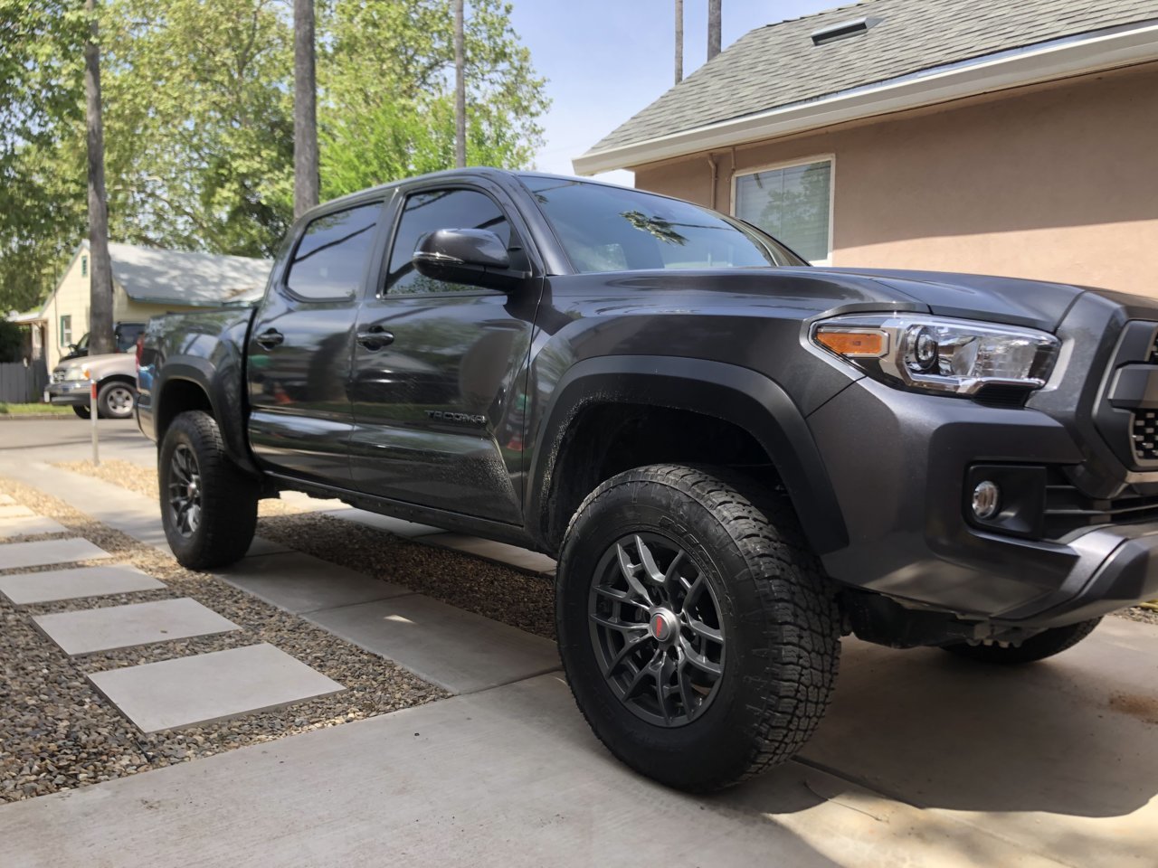

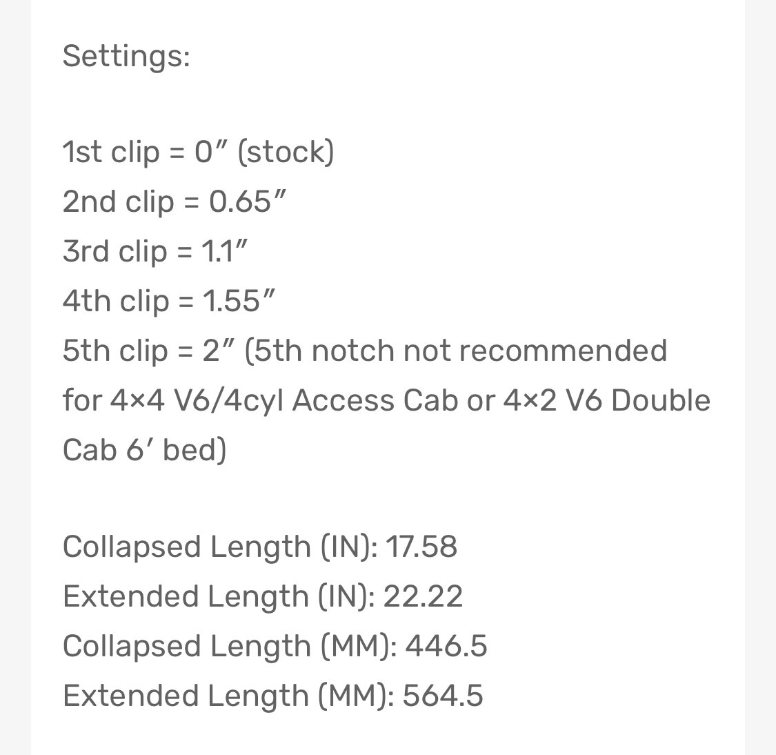

    Actually doing my 5100 lift/level today. I’m 1.75 lower front left and 1.5 lower front right with 265/79/17 tires. Was gonna go 1.1 setting but thinking of going 1.55 and hoping it settles below that.

    Bilsteins 5100s on the top setting, 4runner Gray TRD Pro Sema wheels, 285/70/17 Toyo AT3s, Sumo Bump stops, TRD exhaust, ECGS Clamshell bushing, 1/4 shim for the lean and one inch rear block, OEM Pro grill and garnish OEM TRD Skid plate, TRD CAI, Demon Brackets, Rigid Industries Pro fog lights, OEM Trail Rails sidebars, Diode Dynamics LED SL1 high and low beam lights, OEM Roof racks, Clazzio leather heated seats, Remote Start, TRD Pro shift knob, tinted windows, Rockford Fosgate 4 channel amp for the headunit and sub and amp combo, OEM Puddle lights, OEM tailgate lock, OEM bed mat, LED interior lights, OEM blackout kit for letters, JLT catch can, upgraded 27F toyota True Start battery, Vleds led tail light kit with Pro tail lights, OEM Rave4 side mirrors with convex spotters,just to name a few mods.
    It's done all the settling it's going to do unless you go with ome springs and then it will settle.

    Took me about 3 1/2 hours. I went with the 1.1 instead of the 1.5. Gained an inch upfront to put me pretty level. Sitting at 37 1/2 inches in the rear 36 1/2 in the front
