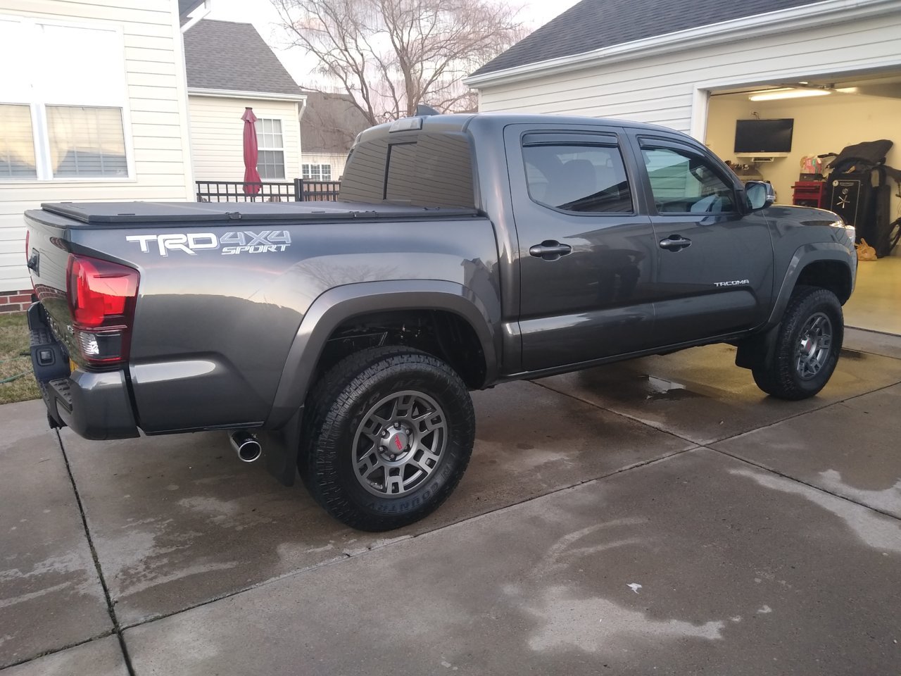

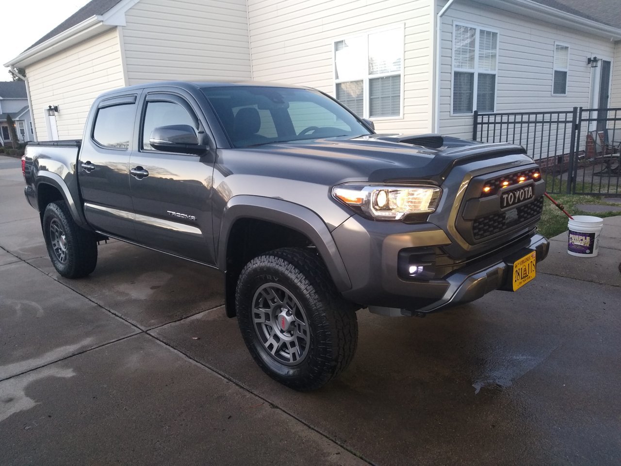

    This is my son's truck and it's on the 5th setting and a one inch rear block, ecgs clamshell bushing, front diff drop, 1/4 shim for the lean, and a rear carrier bearing drop. Rides like stock, no shakes,shimming or vibrations of any kind. Added some e 265/70/17 Toyo open country at2 SL rated tires on TRD pro 4runner wheels. It's perfectly level. IMG_20200126_172543781.jpg IMG_20200126_171607176.jpg

    Added a TRD pro grill and rigid industries fog lights (fake) Clazzio leather seats, remote start, OEM tailgate lock and a flowmaster exhaust.

    Looks great, nice stance.

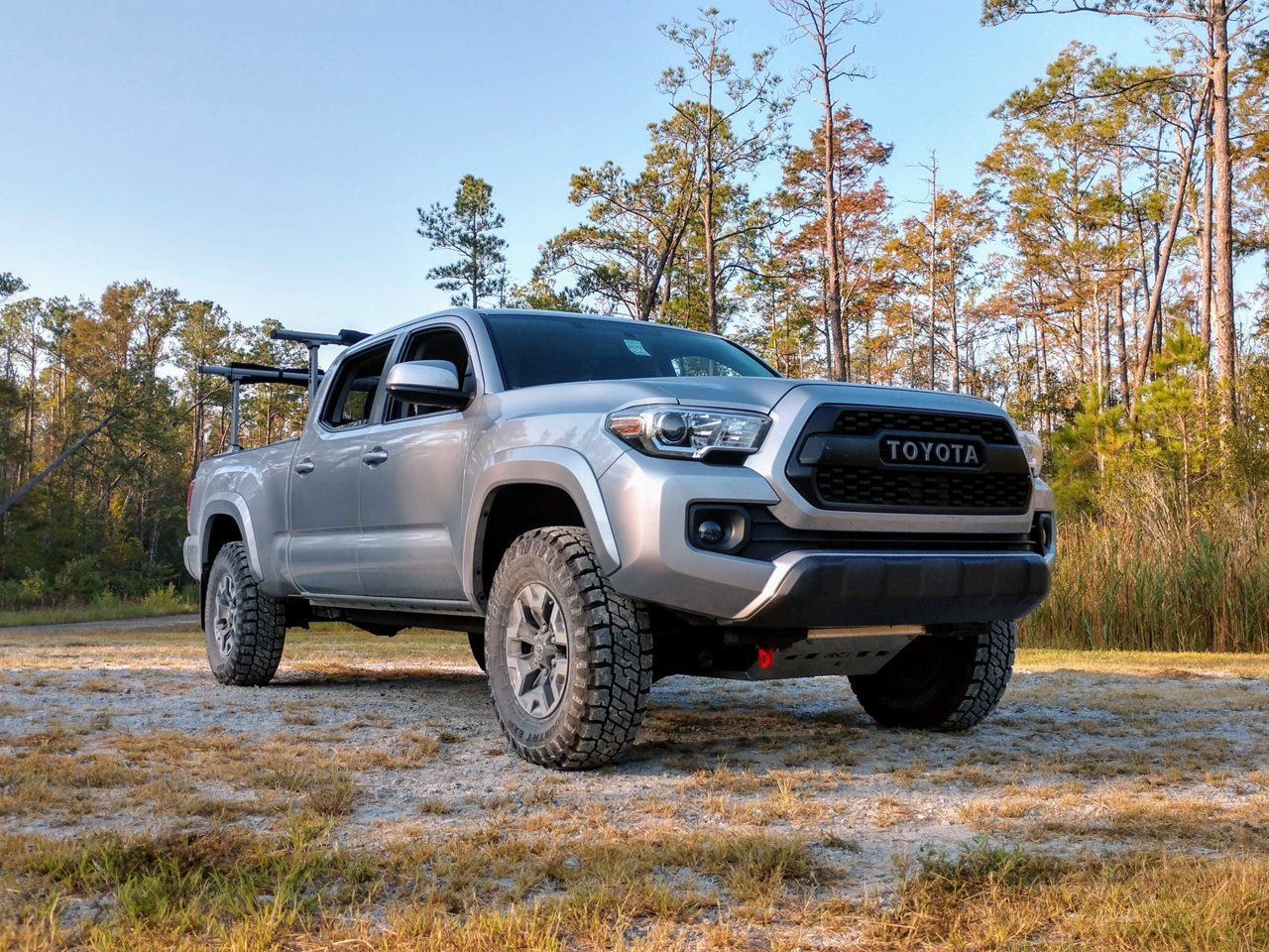

    IMG_20191003_082434154_HDR.jpg I did the second notch .65 and nothing in the back. I still have a little rake and it rides great.
    265-75-16 Dick Cepek EXP.

    I’m telling ya.
    Got to have that rake.

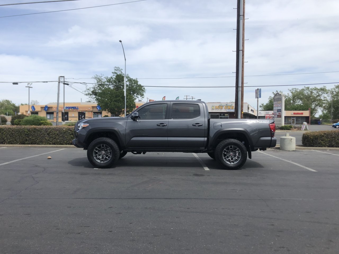

    Here’s mine. 5100s in the front only. Can’t quite remember which notch it’s on but it’s pretty much level. Took me quite a bit of time because I didn’t have coil compressors, but I managed to get er done with a homemade jig and some tow straps. Coil compressors would have cut the time in half though haha
