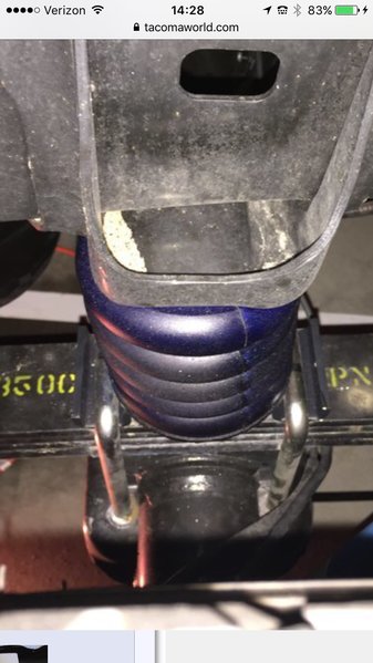

    2000man The Church Of @ODNAREM San Diego Chapter 1904
    Mar 16, 2016
    #181482
    2,922
